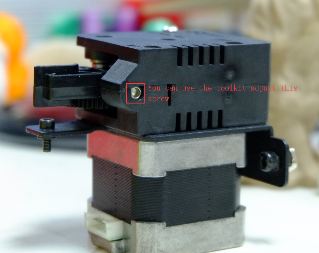

1.If you find the nozzle no filament out
1)Check your PTFE tube plug is deep enough/Smooth
http://geeetech.com/forum/viewtopic.php?p=88482#p88482
2)Refer to this video clean your hotend
https://www.youtube.com/watch?v=evslMa5Jpc8&t=56s
3)Check the extruder motor direction is correct
If the direction of it is not correct, refer to the part of"Motor"

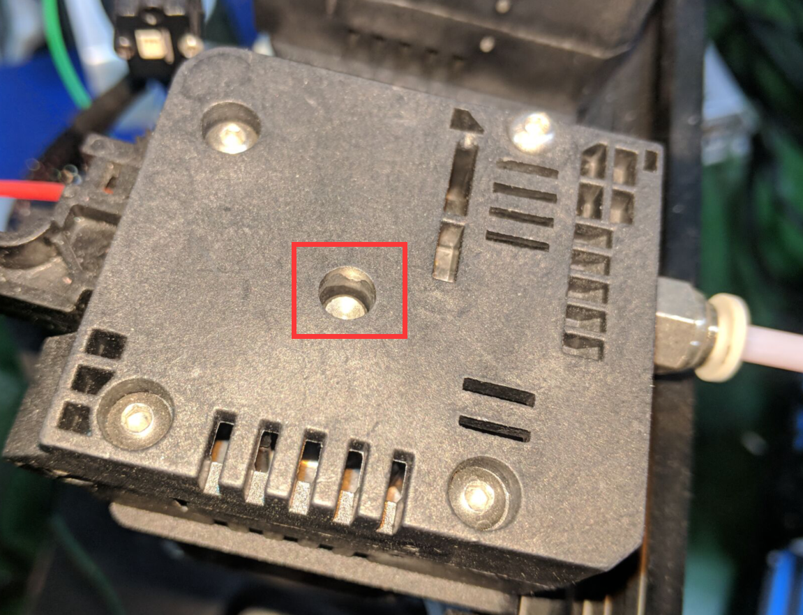

4)Check the spring of the feeder have enough strength/Too strength of the spring will make the filament broken
Feeder screw.png (1.07 MiB) Viewed 78823 times

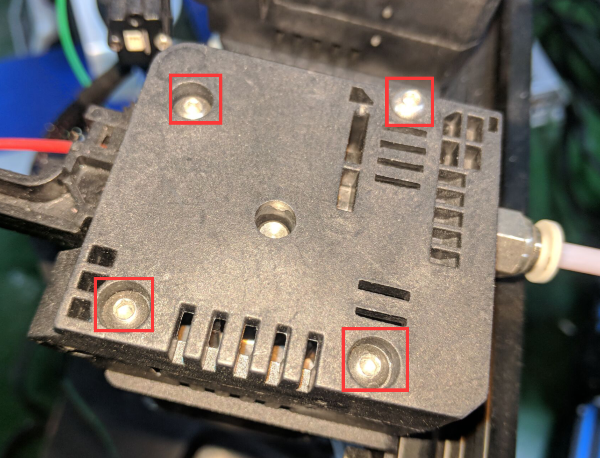

3.The extruder is very noisy A10M
1)You can add the oil to this area
Add Oil.png (1.41 MiB) Viewed 82209 times
2)You can loose a little for the screws
Loose the screws.png (1.49 MiB) Viewed 82209 times

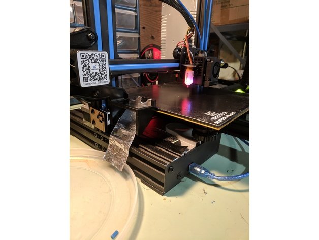

4.Add the purge bucket for your A10M/A20M
Refer to the link(By cmhnav Feb 2, 2019):
https://www.thingiverse.com/thing:3395883
Purge Bucket.jpg (45.49 KiB) Viewed 79254 times

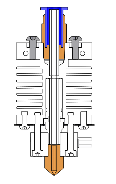

The nozzle type of A10 is m6 thread;
Hotend of A10:
The nozzle type of A10M is m7 thread;
(It is not the standard MK10 4mm inner diameter nozzle.You need to check it at first.The default inner diameter should be 2mm)
3.Hotend clean and nozzle replce

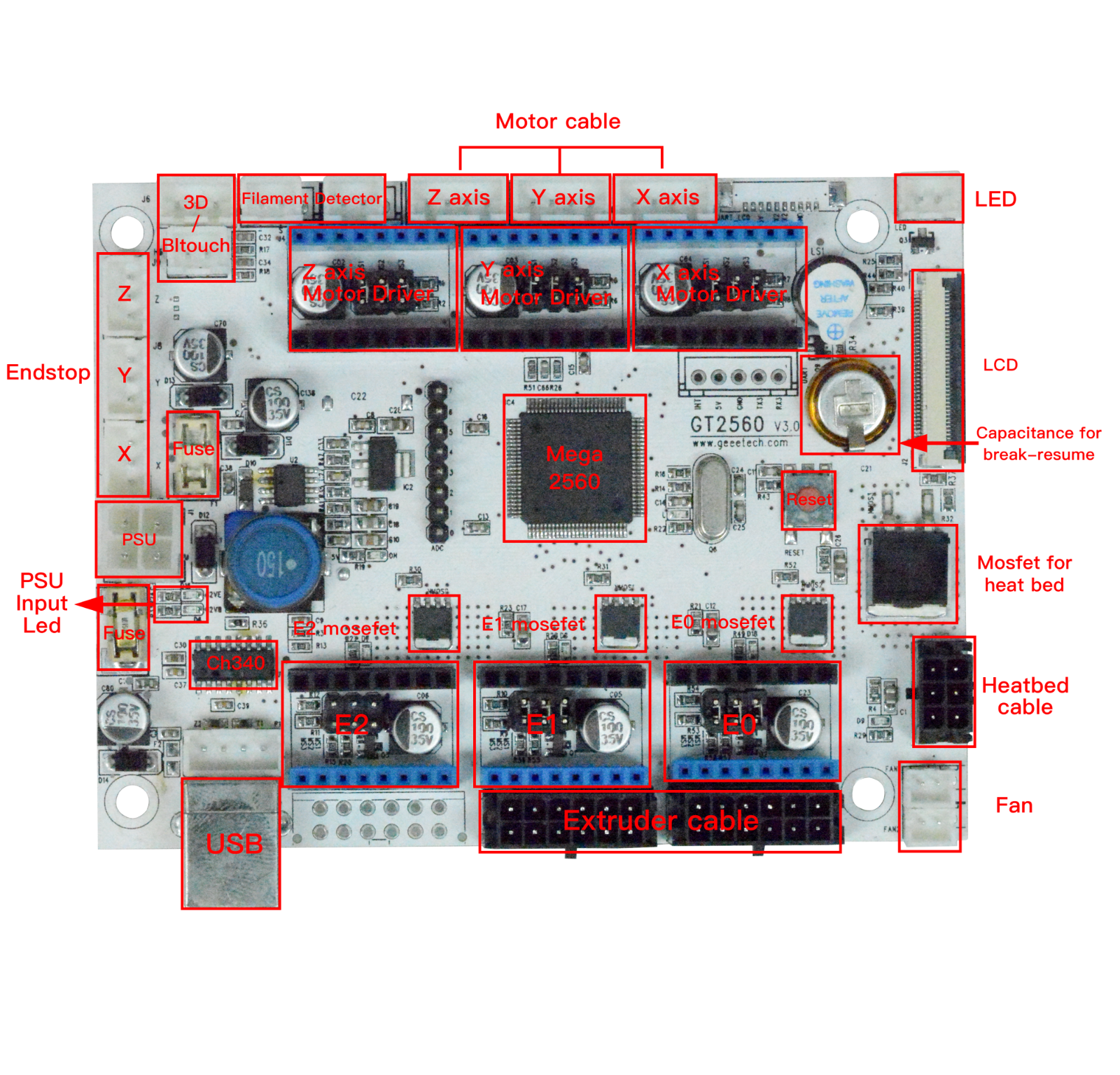

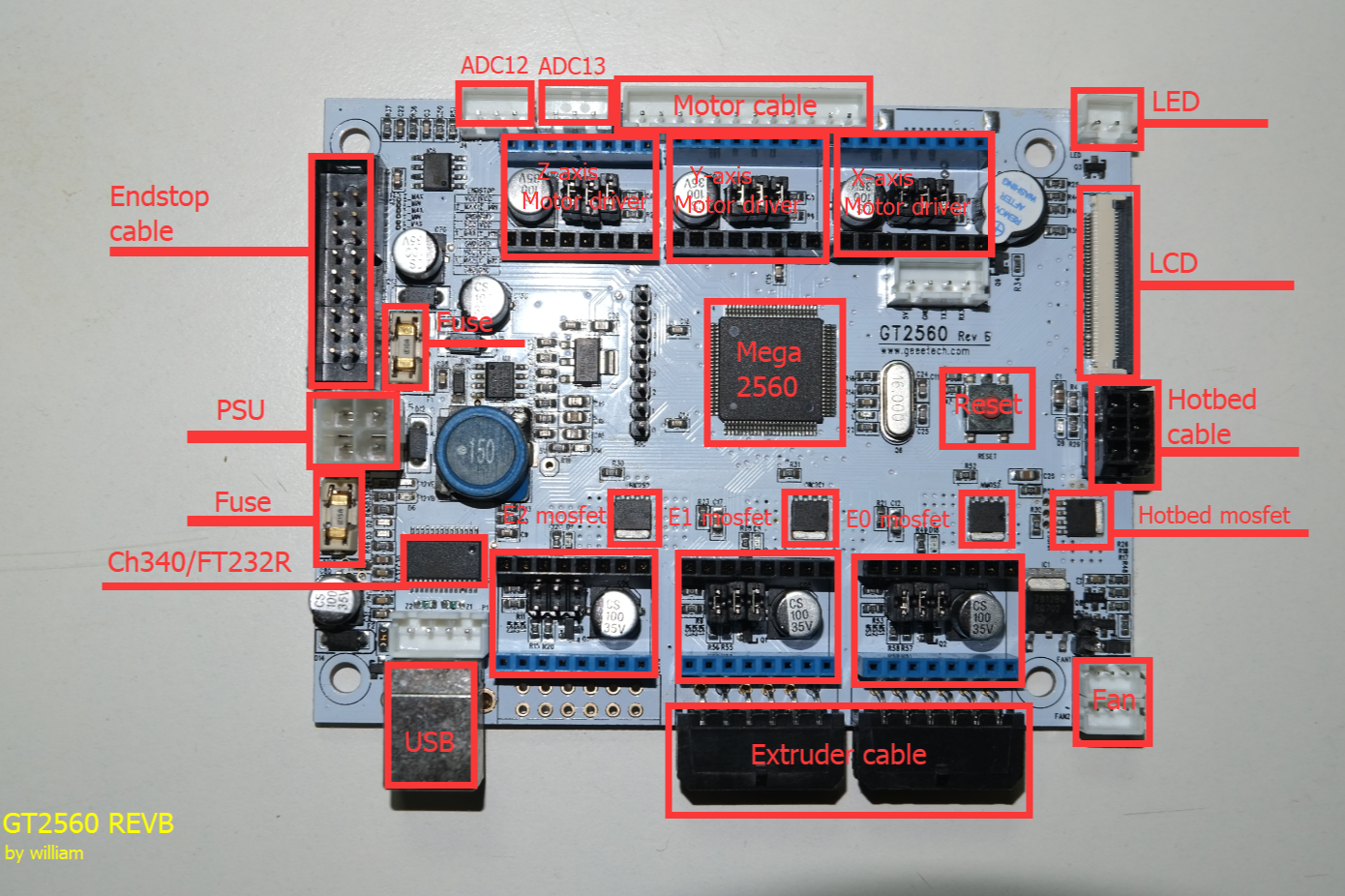

Schematics
Schematic for the old version Mainboard: GT2560 Rev B
Schematic for the new version Mainboard: GT2560 V3.0
Wiring of GT2560 Rev B
GT2560 Rev B2.png (1.64 MiB) Viewed 78827 times
