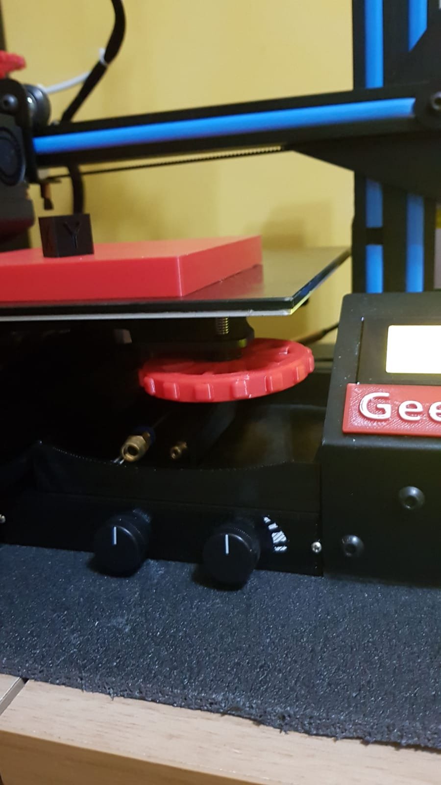

299/5000
In fact I solved with only one potentiometer connected to the PJ2 jumper.
In this way the Jumper is open (just do not put the potentiometer to maximum) and you can adjust the voltage from 12 to 24 volts, then the voltage regulator does the rest. Noise is gone and the prints are excellent.

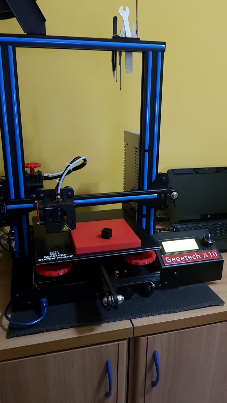

Re: How to start up the 24V fan.
dinopoli wrote: Thu Nov 29, 2018 6:10 am 299/5000
