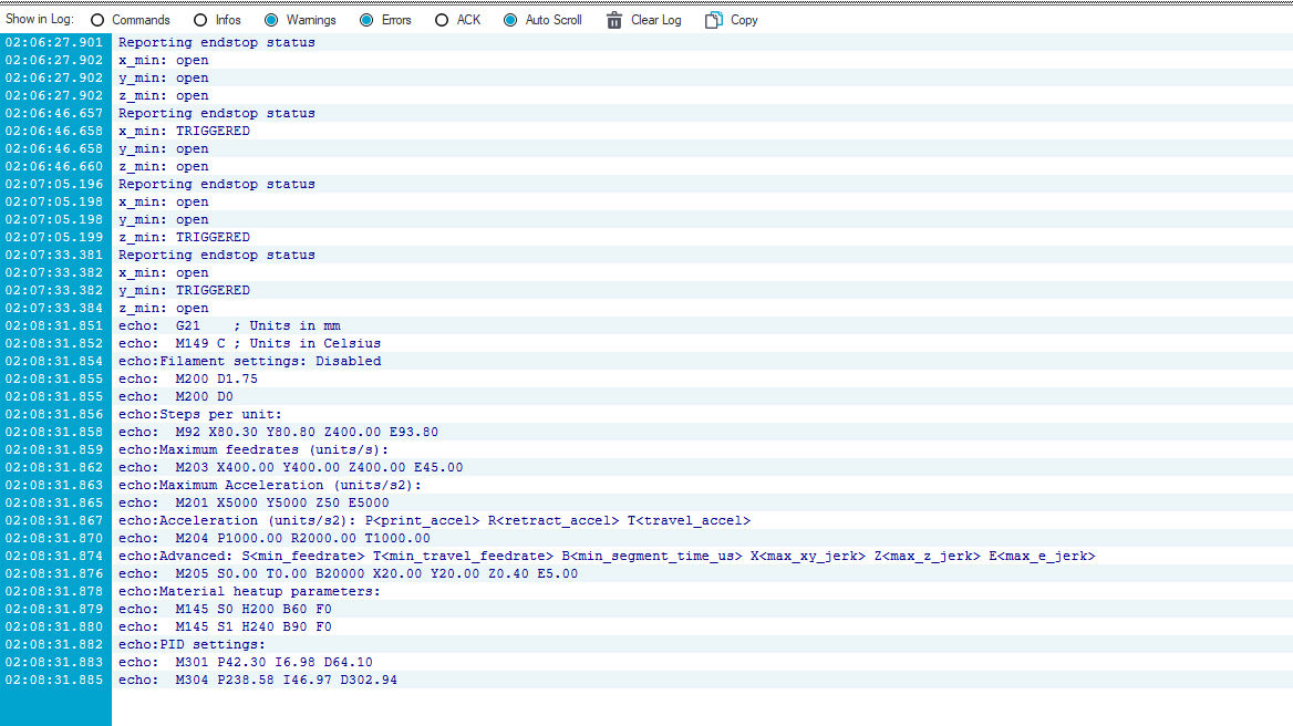

I did the M119 test on the endstops and they report they are being triggered. I am at a loss.
