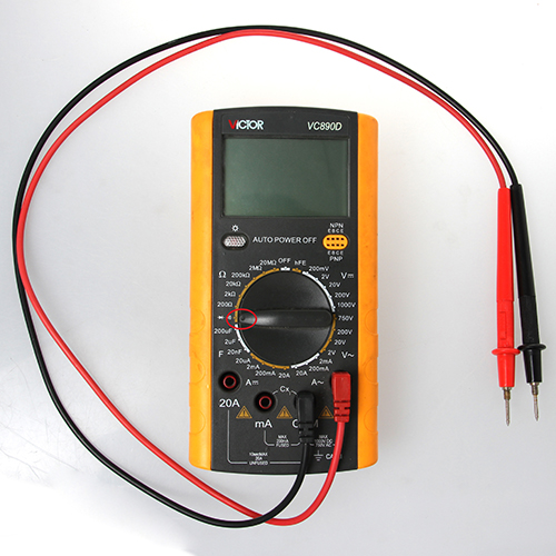

first,set your multimeter like picture 4021

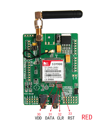

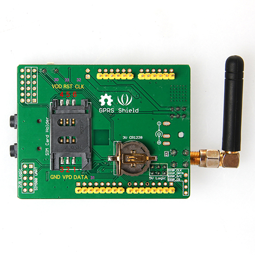

then test that does the simcard‘s pin short with sim900 pin’s or the pin‘s current limiting resistance like picture 40265

1.you shold set the multimeter like that
2.test that the Wiring is welll
(use red Probe)

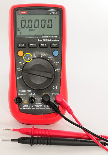

1.first,set the multimeter like this
2.test that these signals is connected,if not,the resistance is not soldered well。

i don't think it's right,cuz that number 2 in sim card it ’s not connecting with sim 900 resistance between simcard pin4、5 and sim900‘pin 30、 33,and there are Not with resistance grade,but diode gear
bzuk
Posts: 13
Joined: Tue Aug 05, 2014 10:08 pm
Re: GPRS Shield does not work
Post by bzuk »
I did measure directly the SIM900 pin30-33 and I measured the same values, Therefore, I measured the resistance test between sim900 pin30 and cardconnector pin4 0,23ohm and tests show it's soldered to the well, sim900 pin33 and cardconnector pin5 21,8ohm
