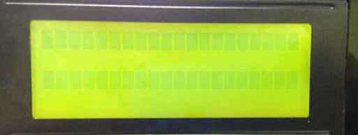

Buzz wrote:I haven't got your reply. I have a GT2560 board in a G2S Rostock. To date I am not able to get the printer to respond, getting command waiting in the Repetier Host and the LCD showing 2 lines of block.
regarding to the block on LCD,please reset LCD by press button below the LCD knob.
regarding to the comand waiting,please repluge the hotbed heating wire and extruder wire.could you tell me what LCD show shows,please sent me the LCD picture.

The reset button does not work. It still shows 2 lines of blocks. I have already unplugged and re-plug in the hotbed and extruder wires before I post the problem. It is still giving me command waiting. Is the firmware in the GT2560 corrupted that requires reburning?

I too have a wacky display. Was fine until I updated may Sanguinololu with Marlin 1.1. Now printer is fine but display is 'blocked'. I suspect there is a problem in pins.h. Any help? I have the Aluminum Prusa i3 with the 2004 display. Maybe somebody could post the stock factory configuration files? Thanks.

Hi, for LCD2004, if you get the backlight and two rows of rectangles as the picture shows, it might be the wrong settings of firmware.
For LCD2004 you should delete the “//” from this line of the code“//#define REPRAP_DISCOUNT_SMART_CONTROLLER”; And add “//” in front of the code” #define REPRAP_DISCOUNT_FULL_GRAPHIC_SMART_CONTROLLER”, because this line is for LCD12864. Then upload the firmware.
