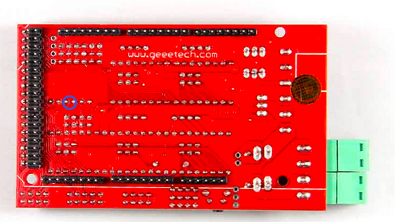

Please check if this 2 pins hightlighted in the picture are linked toghether:
mediaklan
Posts: 63
Joined: Wed Mar 04, 2015 4:00 pm
Re: Wiring the fans
Post by mediaklan »
Hmm ... very interesting zhangxueyou ! Thank you for your help, as always. But it looks like just as your picture. These pins are not linked together from what I can see. I guess they're not supposed to be.
I forgot to mention this : even if I disconnect the bed entirely (power and thermistor), i'm still getting the maxtemp bed error. Is it normal ? Or it is not looking good at all ?
