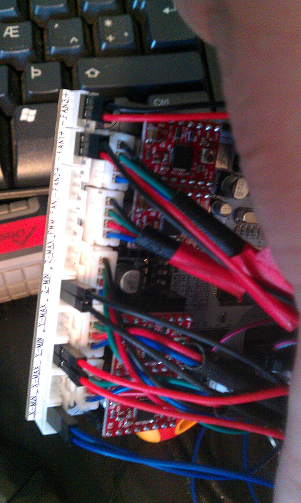

Oh, your board type is GT2560. There's no jumper cap.
Then you should check if the printing model is amplified on y direction.

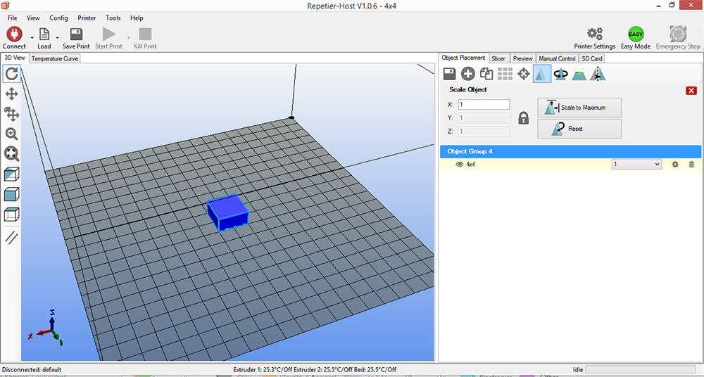

Post by 3DPO »
model always look regular in repetier host.

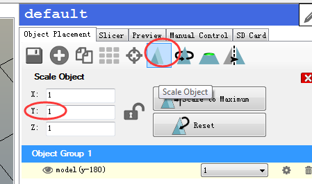

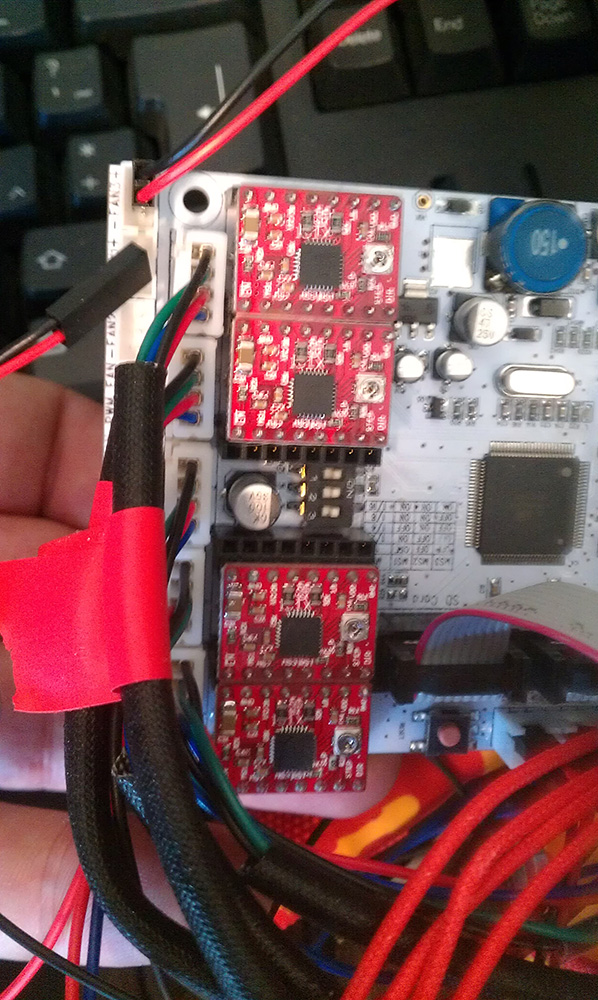

Look at the picture, but please make sure all the switches under A4988 are on. The picture you show me is Z motor.
And please make sure the red wire of fan should be connected to "+", otherwise the fan will be dead.

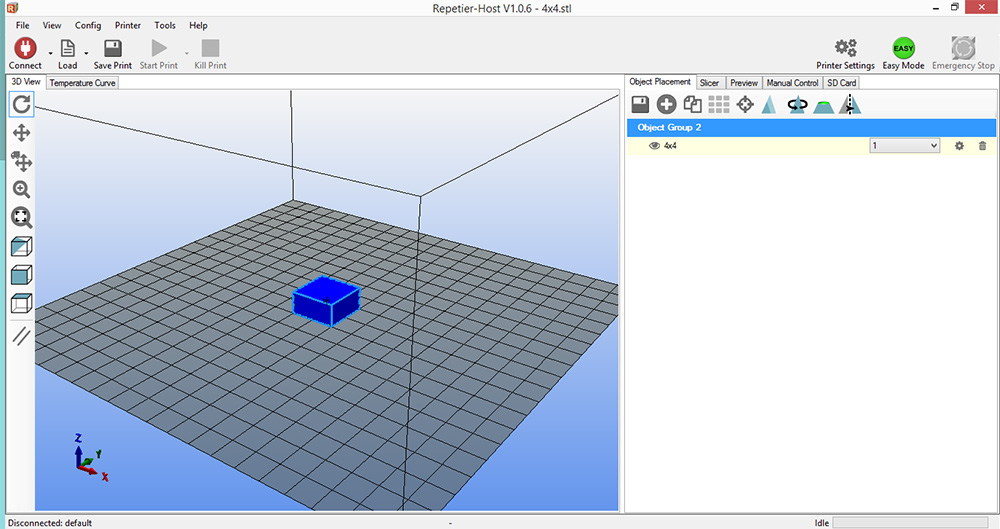

Post by 3DPO »
all the switches are on and the fan is plugged in. Please see the attached gcode and photo, scale of everything is set to 1. I did try setting the Y-axis to 0.25 which brought the print close to correct size. Can you tell me how to fix this?
