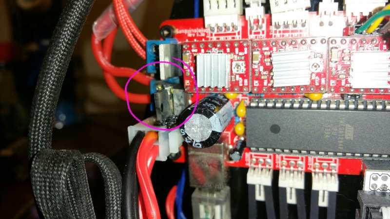

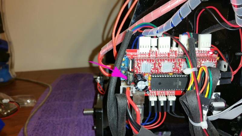

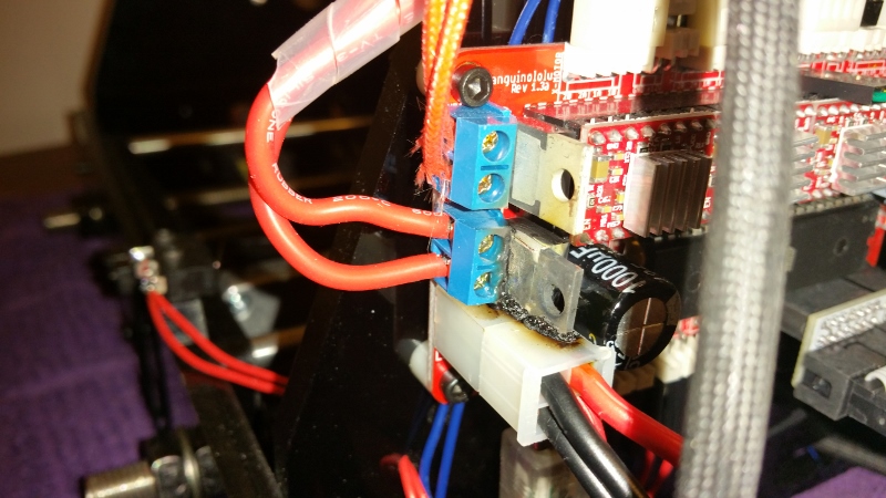

I got my prusa i3 with sanguinololu 1.3a board up and running pretty smoothly for about half a roll of pla filament but a component on the board failed. see attached photos.It looks as if the component next to the output for the heated bed is burned up. The rest of the board seems to be functioning normally but the heated bed will not turn off, so the printer is not usable at this time. I believe the board has a defective component and i was wondering what geeetech's warranty policy was and if they will replace the board. Is this a known issue or just an isolated bad component.
zhangxueyou
- Posts: 1405
Re: problem whit sanguinololu card
You can replace a new MOSFET yourself.cadfinger wrote:I got my prusa i3 with sanguinololu 1.3a board up and running pretty smoothly for about half a roll of pla filament but a component on the board failed. see attached photos.It looks as if the component next to the output for the heated bed is burned up. The rest of the board seems to be functioning normally but the heated bed will not turn off, so the printer is not usable at this time. I believe the board has a defective component and i was wondering what geeetech's warranty policy was and if they will replace the board. Is this a known issue or just an isolated bad component.

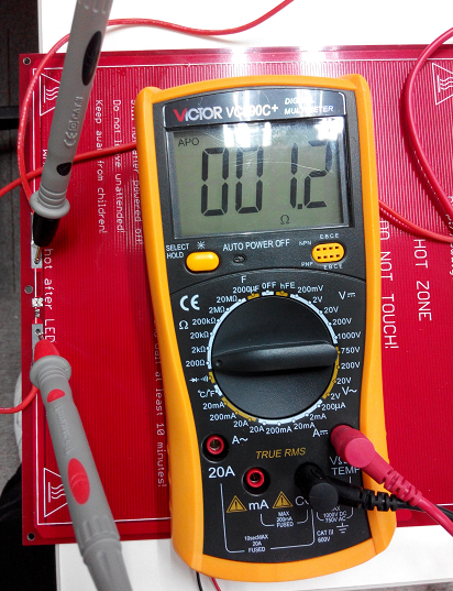

What is the resistance of the heated bed?
I'm not sure what the resistance is. How do I find that? My heated bed is the Mk2a supplied by Geeetech ,in the printer kit.
zhangxueyou
- Posts: 1405
You should unplug the heating wires, and use a multimeter to test the resistance like this:cadfinger wrote:I'm not sure what the resistance is. How do I find that? My heated bed is the Mk2a supplied by Geeetech ,in the printer kit.
