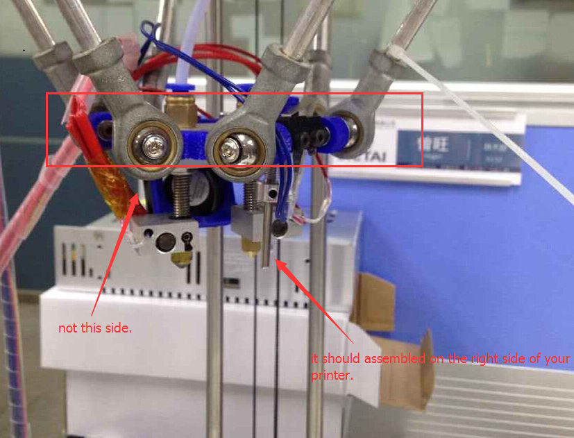

What position did you assembled the probe? it should be on the right of the spider, as the pic shows:

I was having this very same problem until I replaced my spider and hotends. In replacing them it cause me to really be careful about reassembly and I even took photos. The key I think was that
  • I took a couple of small drill bits and drilled out the probe hole enough to make it move freely,
  • then I took the round sanding tool that Geeetech sent with the kit to clean out the top end of the probe holder to ensure that there was no sticking
  • and finally replaced the lock ring with a brass fitting, which I believe everyone has had to do to get this to work.
The other think is something that Geeetech support insisted that I needed to get right, otherwise the auto level would never work and that is to make sure that when you assemble the spider and you are looking at the printer front on (the LCD is closed to you, X on your left, Y on your right), the probe must be installed in front and to the right of the nozzles.
The probe MUST be on the right hand side pf the spider assembly, the nozzles will end up behind it.
Below are a series of photos that show the way my G2S spider assembly was assembled to ensure that it worked with the G20 auto level command.
Let us all know how you go. OH Most important!!!!! When you start to set up your printer, the bench or table you set the machine on MUST BE LEVEL then start configuring your printer.
Cheers, Rick

HI Mark and Rick,
Thank you for your input. I did have the spider the wrong way round initially, but Eric (from Geeetech who sometimes posts on this forum) pointed out my error. I have subsequently reassembled the spider as shown in the attached image. The probe is on the right, the X to the left, Z at the back and Y on the right as you recommended Rick. I also widened the hole. I have not drilled it out as recommended by Mark and Rick as yet but with the silicon oil, the probe moves smoothly so I did not believe that friction was the issue.
