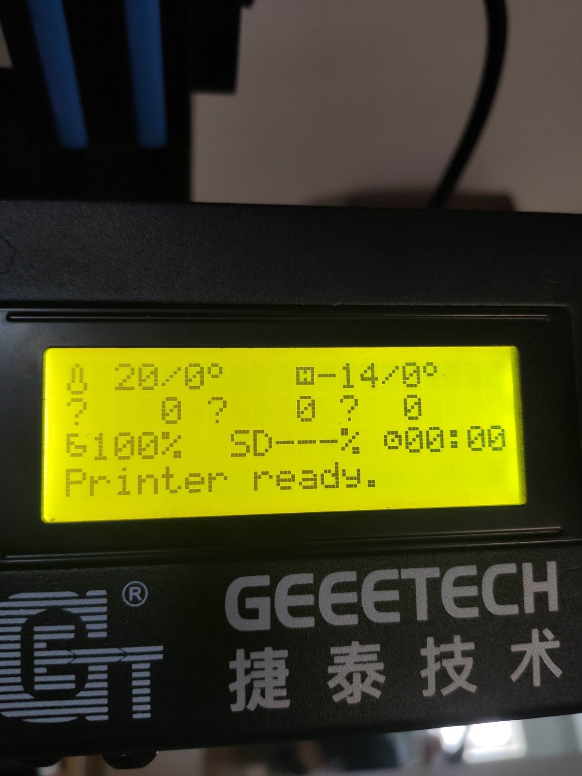

when I disconnect the thermistor cable, I have -14/0 and when I reconnect I have 358/0, is the motherboard defective?
Re: How to slove the problem of MAX/MIN TEMP error(GT2560)
Hi, if this.
it is the hotbed thermistor problem.
You need to replace it.
