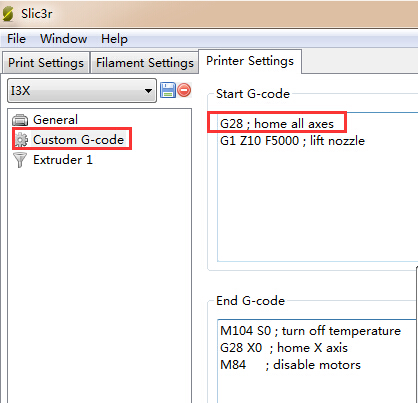

did you guys add an homing command in the start gcode command list? before the printer start to print it should be home itself and then start to print, if not it might behave like what you said.

@Mark
I looked up the custom code section and it is the same as yours, the factory setting.
