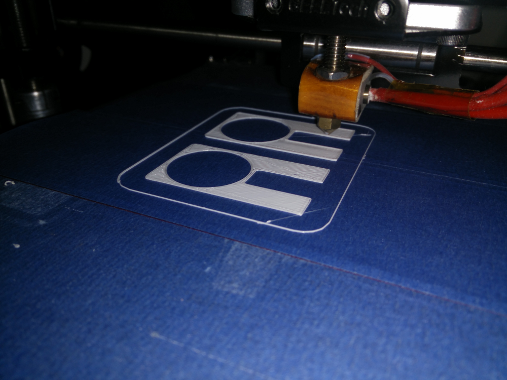

Forgot the pic...
//UndCon
//UndCon
- print.png (755.45 KiB) Viewed 36686 times

Personally I use the printed parts above and a 2nd version that has a regular HEX-nut
I have no issues on Z with above mod and it took like 20 minutes to print.
