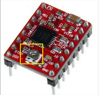

I'm not sure if you've missed something...And have you tried to swap the driver module of the extruder motor with the driver module of the x or y axis motor?Cuz as you say,i guess there is insufficient driver ability to the extruder motor.Here is the driver module:

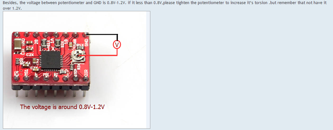

Yes , I have it Set to 1,15volts.

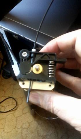

No, everything was great. All engines are running well.
I can see the wheel, it rotates when try to print. I use a flashlight and also in the right direction.

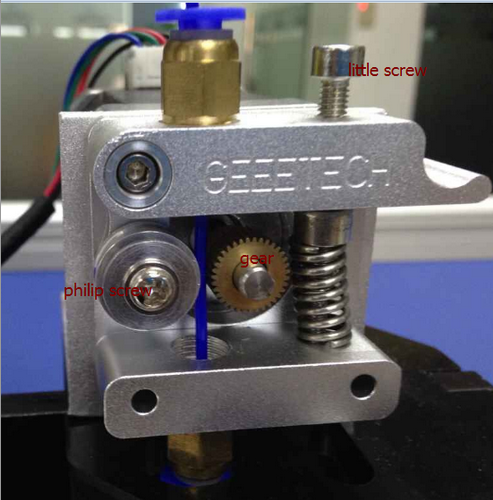

If that is also correct,the reason i can think can only be the gap between Philip screw and gear,you can adjust the gap little by little until it is appropriate. :o

I can not unfortunately adapt because I can not get close to this Philip screw or set at all.

The attachment 13444375_10205639647984790_932889321_n.jpg is no longer available

I just looked the extruder as yours,and i tried to plug the filament into it,i found the gap was enough tight.So i think the pressure is sufficient to the filament to flow.

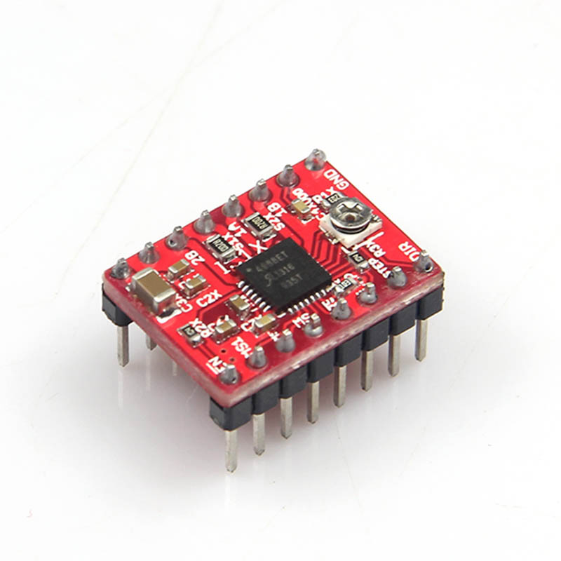

Finally,if those are right,you can have a try to increase a little dirver voltage to 1.3~1.5V by adjusting the potentiometer screw below:
Good Luck!

i did this and put on several volts 1,35 1,45 and 1.5v ... and now only buzzing the engine but nothing else happens. That just can not be right
