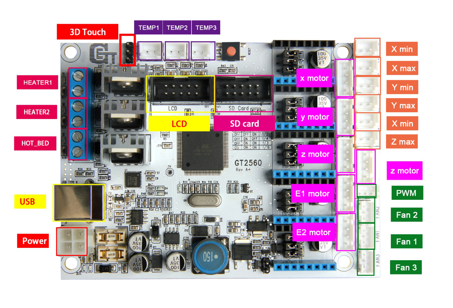

I read that you have the BL touch sensor to run with the firmware. AS? Pin layout I have copied from page one, since I have searched for the 3 pin Z max, must say I'm disappointed by Geeetech, could bring your documentation up to scratch. And I'm not allowed to send any private nanchips to the monkey either, THANK YOU GEEETECH, WHAT'S WITH YOUR DOCUMENTATION?
Tweeted with firmware from 1.1.4 to 1.1.8. Everything without success. Either the Z axis goes up during testing ... or when driving down and test he can not drop the needle to test, WHY? In the tests upwards (which of course is totally pointless, he also drops the needle)?

1.I think you should upload the wiring of your mainboard.Szandor wrote: Sat Mar 24, 2018 7:14 pm Hi,
I would be very grateful if you could share your solution.
Dear, Szandor
2.Upload the firmware of yours(configuration.h+pins.h)
3.GT2560A and GT2560A+ are not same.The pin define servo 0 of GT2560A is 32.
The pin define servo 0 of GT2560A+ is 11
A complaint will not solve any problem

Hola, me pasa lo mismo, la impresora hace el 0 origen en X Y pero al hacer las mediciones en Z el sensor no sale del BLtouch. Alguien sabe porque?
Tengo la rev A+
