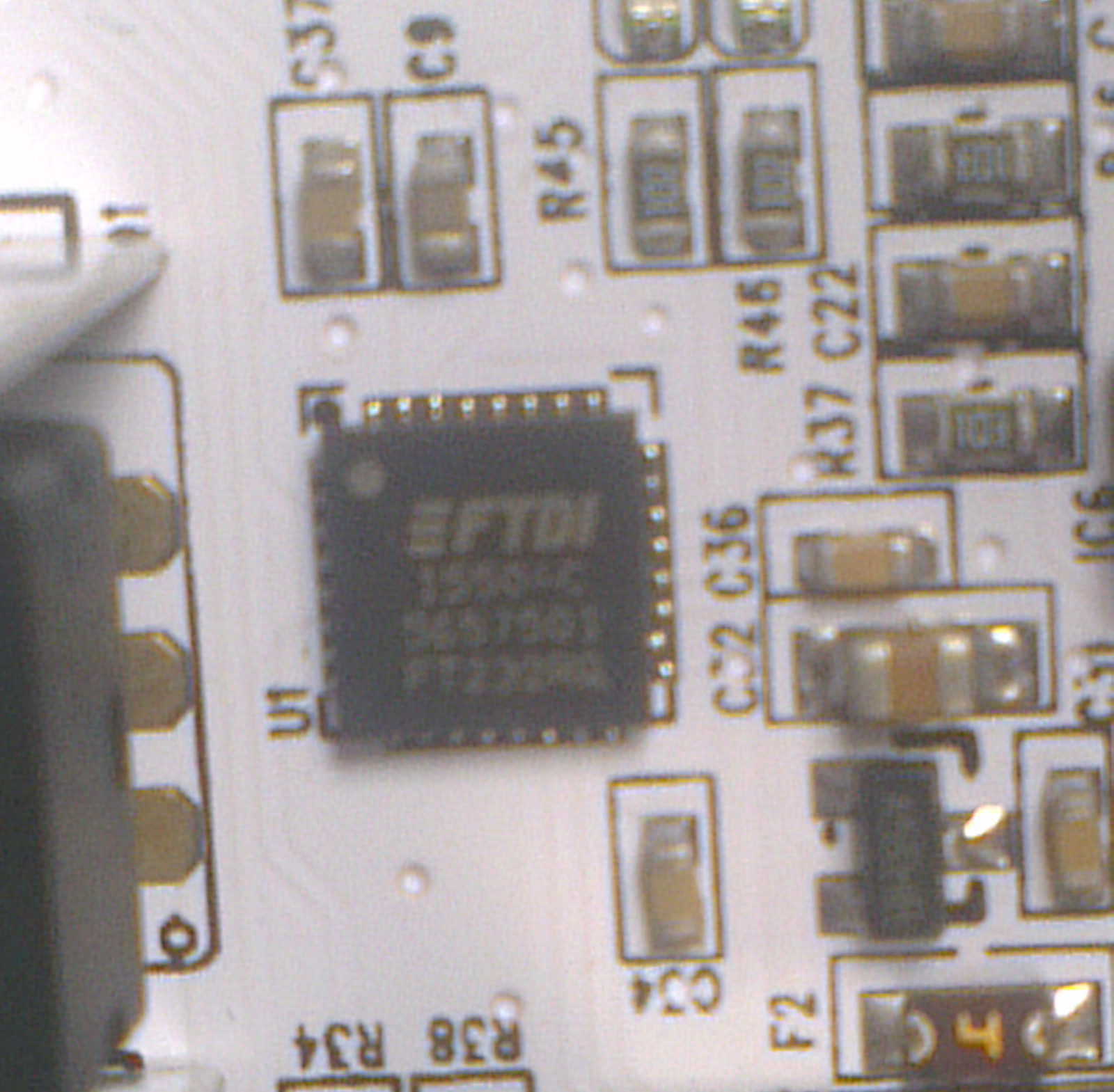

What I did right now, I've reinstalled the PC that is clean and installed your driver but I still have the same problem.
If I connect Arduino with the printer I can see that some of the small LED's are shortly blinking red and that the display shows no content which comes back after a few seconds.
I also tried to upload the firmware again with pressing the reset button before.
What would be the next steps, exchange the board?
Here is a bit better picture.
On the Chip are the following informations:
EFTDI
1550-C
5657501
FT232RQ
FTDI Chip.jpg (503.74 KiB) Viewed 20181 times

cRaZyT wrote:What I did right now, I've reinstalled the PC that is clean and installed your driver but I still have the same problem.
EFTDI
1550-C
5657501
FT232RQ
I'm afraid exchangement is the only way if you have done all of the above...

I guess your issue is different from @cRaZyT's,after all yours worked normally before.So weird...
But i'm suspecting the FTDI chip on your board may be broken somehow,making it impossible to communicate with computer.
EFTDI
1550-C
5657501
FT232RQ
If there is no other posibility which I can try then we have to exchange the board. How can we manage the exchange, would it be done by you or the seller (I think he is directly from Geeetech) or...?
