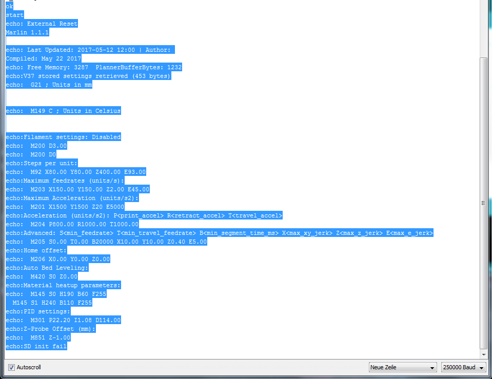

Ok I'm testing it with my gt2560 and Arduino IDE now and I get a response at 250000 baud...
But the speed might depend on the flashed firmware...
Try to reset/reboot your gt2560 while watching the serial monitor. At least for me it spits out many messages.
Do you have the right com-port selected?
And is your board even recognized by your computer (Does a new com in arduino ide appear/disappear if you plug your board in/out?
And do you see a change on your display if you insert an sd card?
- gt.PNG (59.7 KiB) Viewed 10644 times
