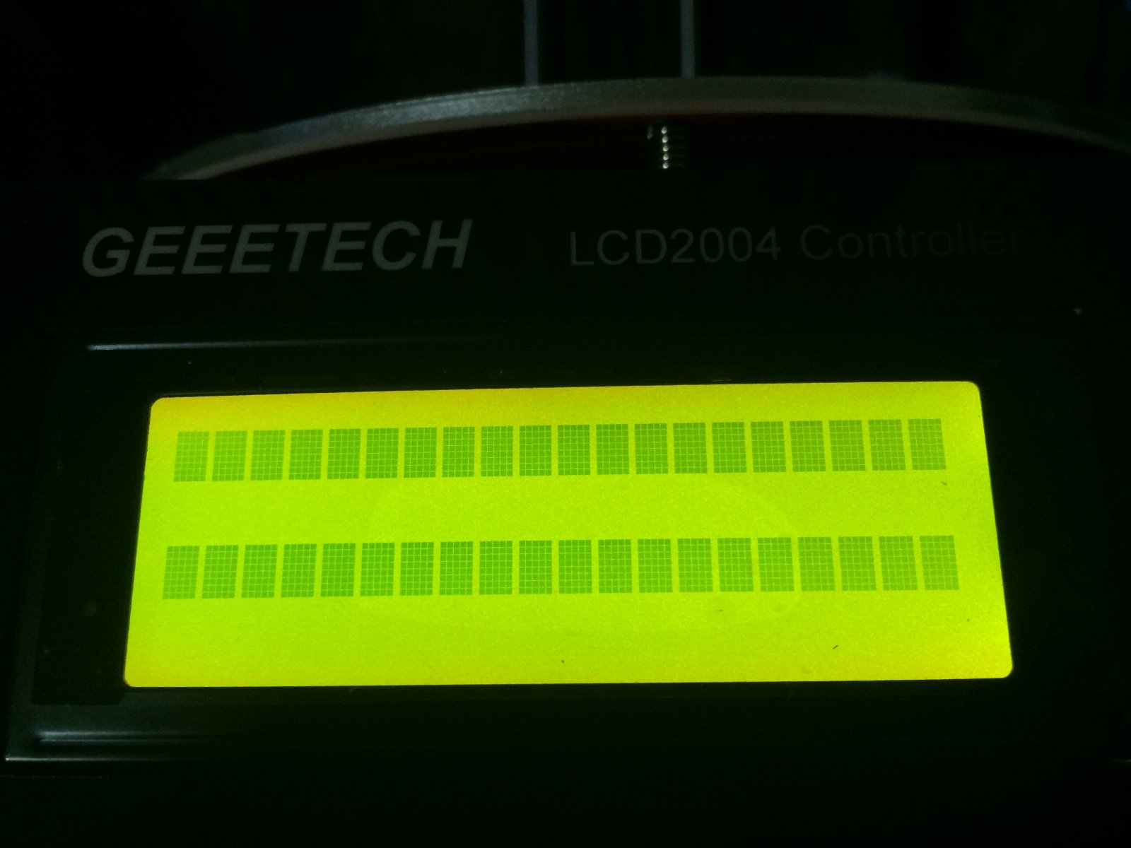

Hello.
It returns to the original, but it does not become 270 ℃.
Learn more How can I install firmware at 270 ℃?
I tried the following.
1. Bootloader V 1.0.1 installation ⇒ NG
2. gtm32 machine delta.bin installation ⇒ NG
3. rostock 301 v1.0.3.bin Installation ⇒OK (Max 220 ° C)
