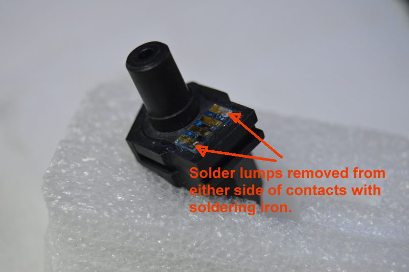

**I finally fixed the erratic temperature and print head errors!!**
In my last post I said I changed the head - and this worked for the first 5-6 prints.
BUT, erratic readings started all over again and the printer kept pausing with nozzle errors every 5 minutes.
However, after looking at the head connector, I realised that the two contacts had large lumps of solder on either side ... thinking that these 'lumps' would push the contacts and cause a bad connection, I carefully removed the lumps of solder with a soldering iron.
I then reinserted the head and ... haven't had a problem since :-)
- e180headSolder.png (484.46 KiB) Viewed 22010 times

Thanks for your sharing!Cool!Tipam wrote: Wed Mar 28, 2018 2:11 am **I finally fixed the erratic temperature and print head errors!!**
I then reinserted the head and ... haven't had a problem since![]()

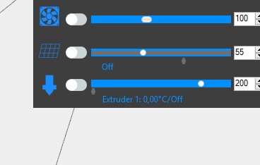

in fact these are the status i see on easyprint screen
both the nozzlend the bed are declared OFF.
- SnapShot2.jpg (7.05 KiB) Viewed 21898 times
- SnapShot.jpg (12.95 KiB) Viewed 21898 times
