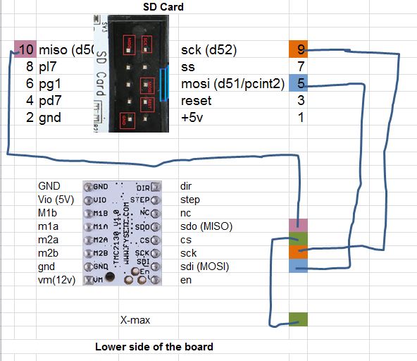

by nitocris
A small schema I've made so far for cabling
- Capture.JPG (65.59 KiB) Viewed 20919 times
Re: GT2560 SPI pins for TMC2130
Posted: Thu Aug 30, 2018 10:37 pm
by nitocris
icelucio wrote: Fri May 18, 2018 3:21 am
Hi all, I'm going creazy.
I've bought TMC2130 from Watterott and also from Cina (Fysetc 1.0) but I' get only "driver error"... I want to ask:
- Do I have to remove the jumpers on the motherboard (MS1, MS2, MS3) ?
- The attached image (open, close, close) is right? for Watterott and for Fysetc I mean...
Thanks in advance, Lucio
Your picture is for Fystec v1.0. Would have been more simple to buy the v1.1 version for SPI
To change from 1.0 to 1.1 you need to open the soldered short cut and to add 2 super small solders
Posted: Sun Jan 06, 2019 6:34 pm
by maciejm
William wrote: Sat Jan 20, 2018 1:40 pm
I suggest you use the TMC2100 because it is quiet and its pin definition is clear
nitocris wrote: Thu Aug 30, 2018 10:32 pm
Hello William,
can you explain what the following PINS are used for, as visible it the schema of SD Card connector by Nitocris from 30 Aug 2018 14:32:
PL7
PG1
PD7
Is it possible to use this pins as SS (Slave Select) for SPI communication to TMC2130, without giving up the SPI communication with SD Card or any other LCD 2004 functionality?
