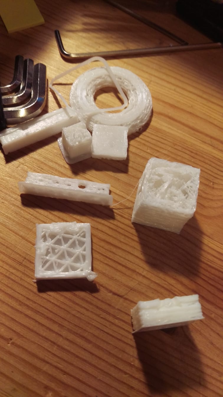

Hey guys!
i'm having some difficulties to make a proper setting in easyjet...
here's my setup:
Win 10 with easyjet 1.2.6
Prusa i3 wood, axis and extruder are calibrated
PLA 1,75mm
seems like the extruder does not apply enough material, see picture.
when i try to set the noozle size to 0,3 mm or 0.3 it automatically sets to 3, same happens when i try to change the retraction.
anyway a print with default settings is very unsatisfying.
btw importing configs is not possible too.
has anyone a clue about this?

Have you tried it on repetier-host?Willem wrote: Tue Sep 04, 2018 6:28 am Hey guys!
here's my setup:
PLA 1,75mm
You can download this file then test it
Re: Easyprint software for WINDOWS
@Willem
Try to set "material flow"
