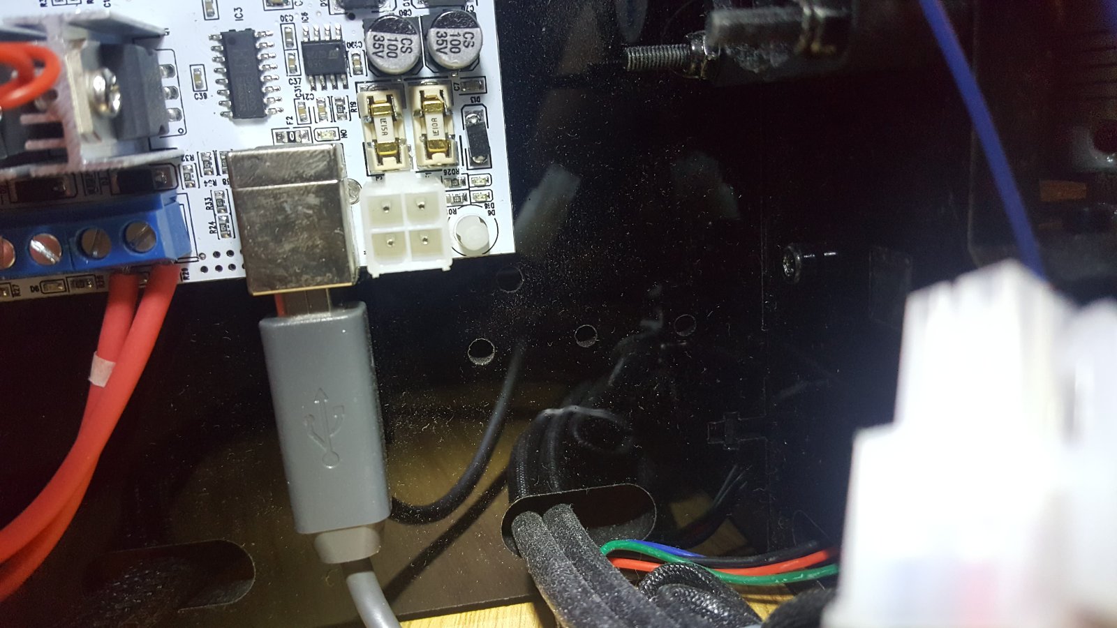

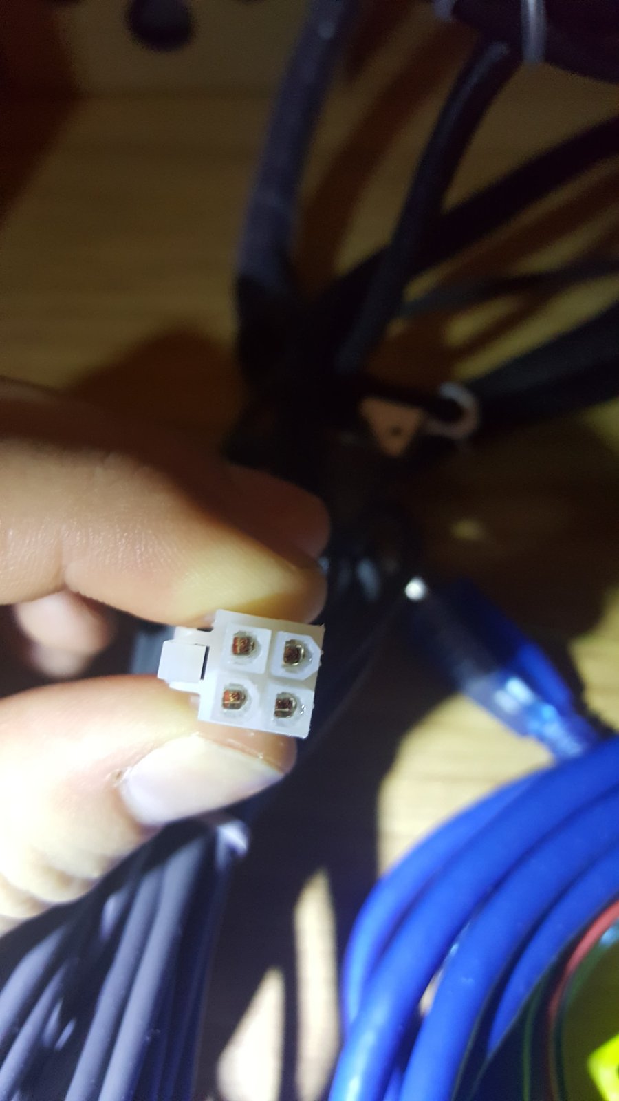

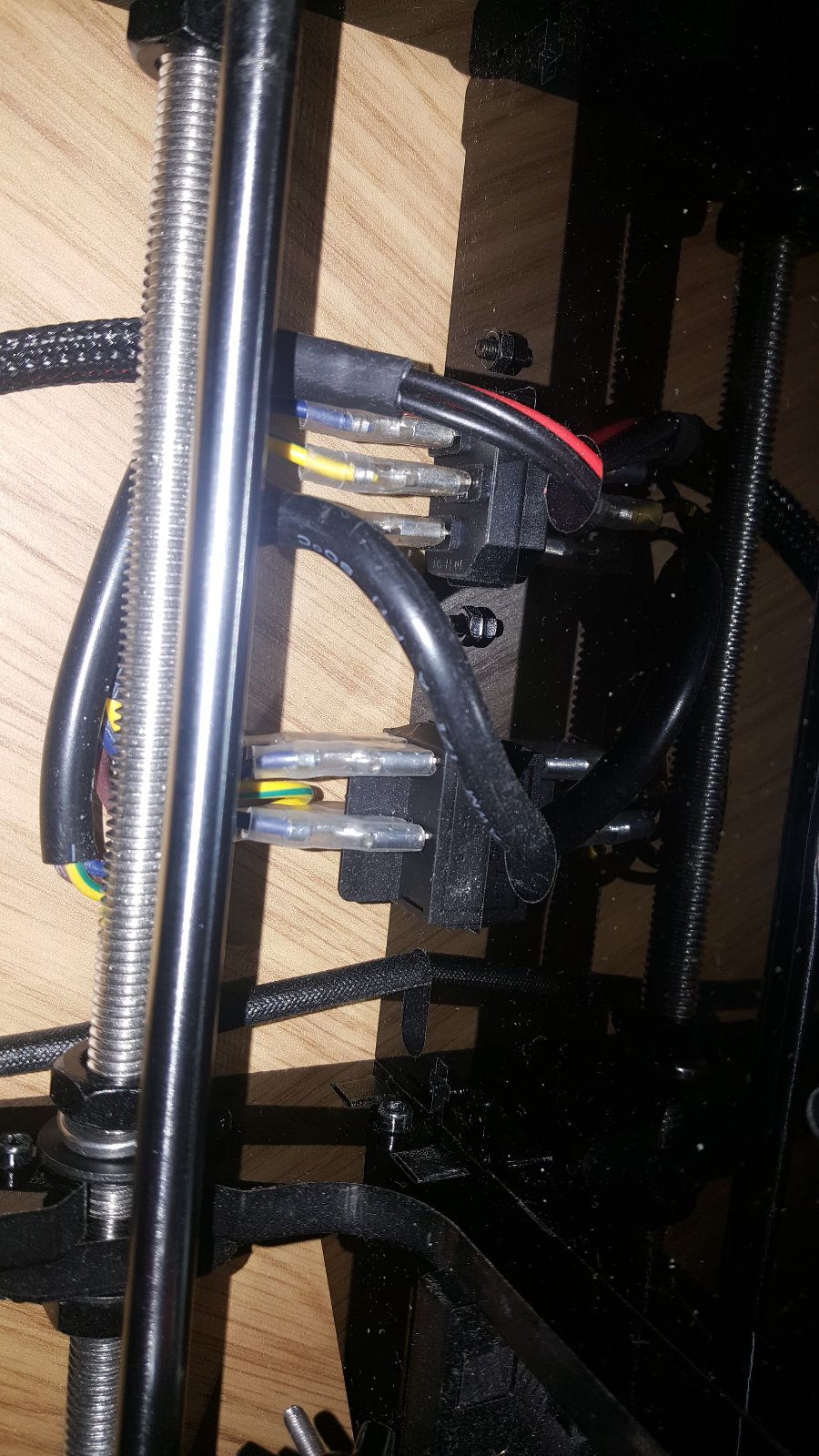

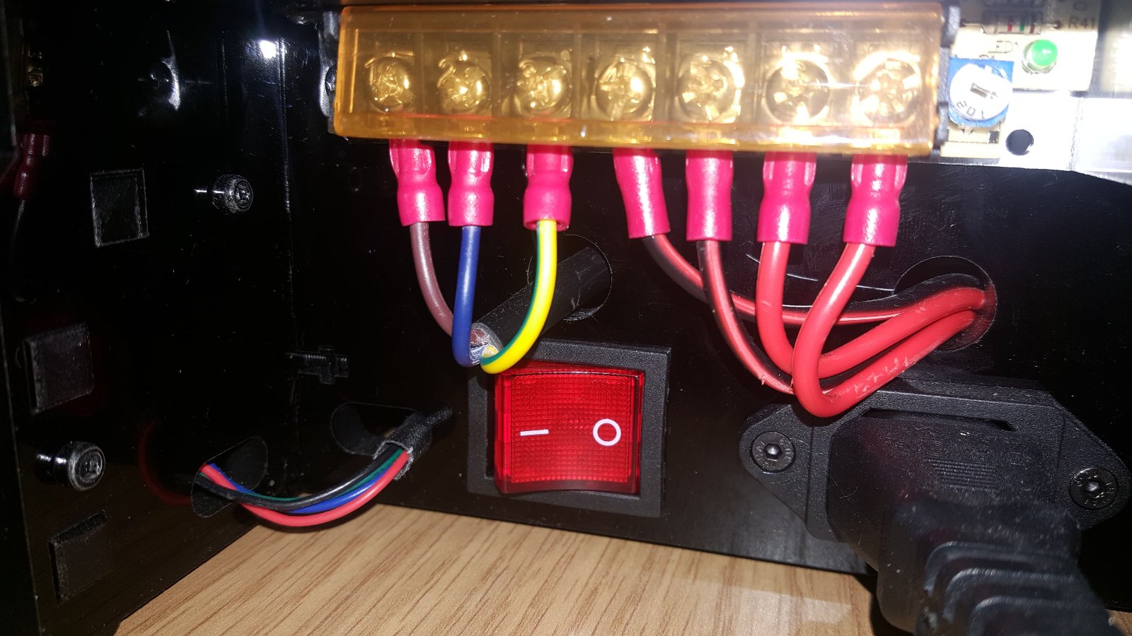

I have looked at the cable ends for the psu and they look fine, I have attached some pictures as well. I also have a multimeter but am unsure what to test and how to use it. Can you please help?
Thanks
Thanks

Re: Communication Timeout
You need to learn how to use the multimeter yourself.
I can suggest that we will need to measure the DC voltage in the range up to 20V. Provided your main power supply supplies 12V.
You will need to know the design of the controller board in order to make measurements. So as to test the main power supply points, and others needed.
So try to look at it carefully.
You will need some point with a ground potential (0V). It would be a good idea to attach one end of the multimeter to this point permanently.
This makes it easier to make measurements. You do not have two hands occupied.
Probably you had no crocodile in the set with the multimeter, just ordinary test tips (spikes).
Earlier you said that you have a GT2560 controller.
That is important. There are other versions, such as GT2560 Rev. A or GT2560 Rev. A+ or GT2560 Rev. B.
The controller board you own has its own "small power supply" built.
It is a step-down inverter that generates 5V0 DC.
In addition, it has redundant components such as a 3V3 and 12V0 DC stabilizer.
For training you would have to find all these points and check the tension.
It is also good to measure the output voltage of the 12VDC mains adapter.
Once you have mastered this range, let us know. We will move on to the next step, where we will measure the two main voltages while the printer is in operation.
We will take the measurements one by one because you have one multimeter.
I greet you warmly.
