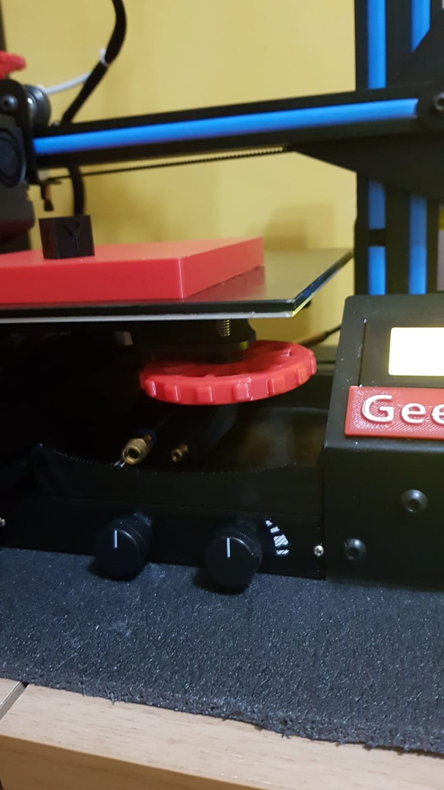

The problem is to be solved on 3 fans and not on one.
If the Jp2 jumper is open, the fans will reach a maximum of 12 volts right?
This voltage is not sufficient to make the fan work properly on the Bowden heatsink (because the fan is 24 volts) which will therefore not cool the heatsink well and there will be a clogging before the nozzle.
This thing has already happened to me leaving the jumper open.
Re: How to start up the 24V fan.
Posted: Thu Nov 29, 2018 6:10 am
by dinopoli
299/5000
In fact I solved with only one potentiometer connected to the PJ2 jumper.
In this way the Jumper is open (just do not put the potentiometer to maximum) and you can adjust the voltage from 12 to 24 volts, then the voltage regulator does the rest. Noise is gone and the prints are excellent.
