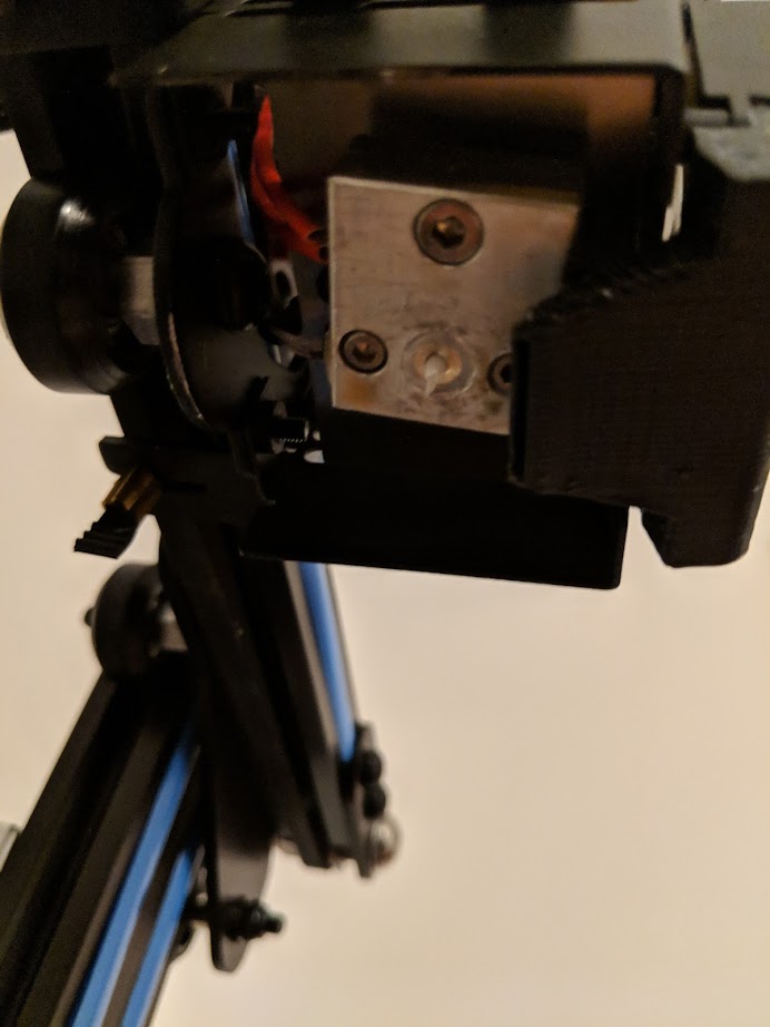

Damnit I managed to break the nozzle and bent the extruder block see attached picture :-(
Can anyone point me to the spare parts i need to order?

Check the FAQ of the A10, then you need a new nozzle.
1.Heating the hotend to 220C, clean it by yourself.
2.Replace the old one.

Re: Extruder leaking? (Solved)
Posted: Mon Jan 07, 2019 12:21 am
by WhippingBoy
New printer head in place the new one is not leaking.
I will order a spare head for next time I have to replace the nozzle..
