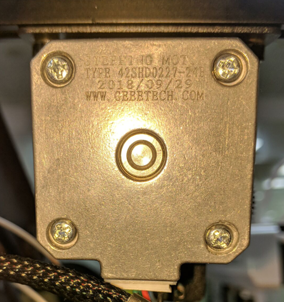

  3. third, which model are stepper motor for extruders on A10M?
@Ricky1966
1. The hotend of the A10 is the 24V type
2. The hotend's heat bar is 35~40W,
3. The extruder stepper motor of A10M is this type
GTA2 motor.png (611.34 KiB) Viewed 12344 times
