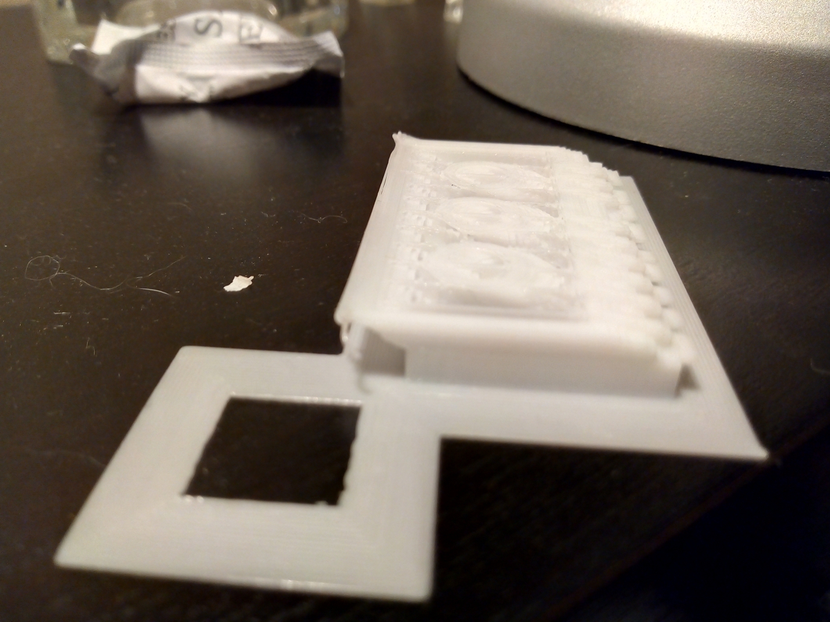

Hi,If you purchased the super board with a paste version,
You can remove the mylar sheet and stick the super board on it;
If it is not pasted, you can use an insulated long tail clip to fix it;
You can provide your print specific pictures so that we can better solve the problem;
If it refers to layer shift, the following aspects can be detected:
Adjust the tightness of the belt properly.
Whether the bearings and pulleys are issued with cards, and the cards can be lubricated with lubricant;
Printing speed reference range: 30-60mm / s;
Drive board voltage range: 0.8-1.2V

Hello
Thank you for the answer.
Here is a (bad) photo of a Lego where we see the layers that shift backwards.
My printer is almost new. I guess there is nothing to lubricate in a new printer. I did not change anything in the configuration. I use Repetier-Host V2.16 and Curaengine with PLA High.
The superplate is fixed with the small clips supplied.
In your answer, I don't know what cards you are talking about, or where to look at the voltage.
Thanks for your help.
lego effondre 01.jpg (621.42 KiB) Viewed 22995 times
