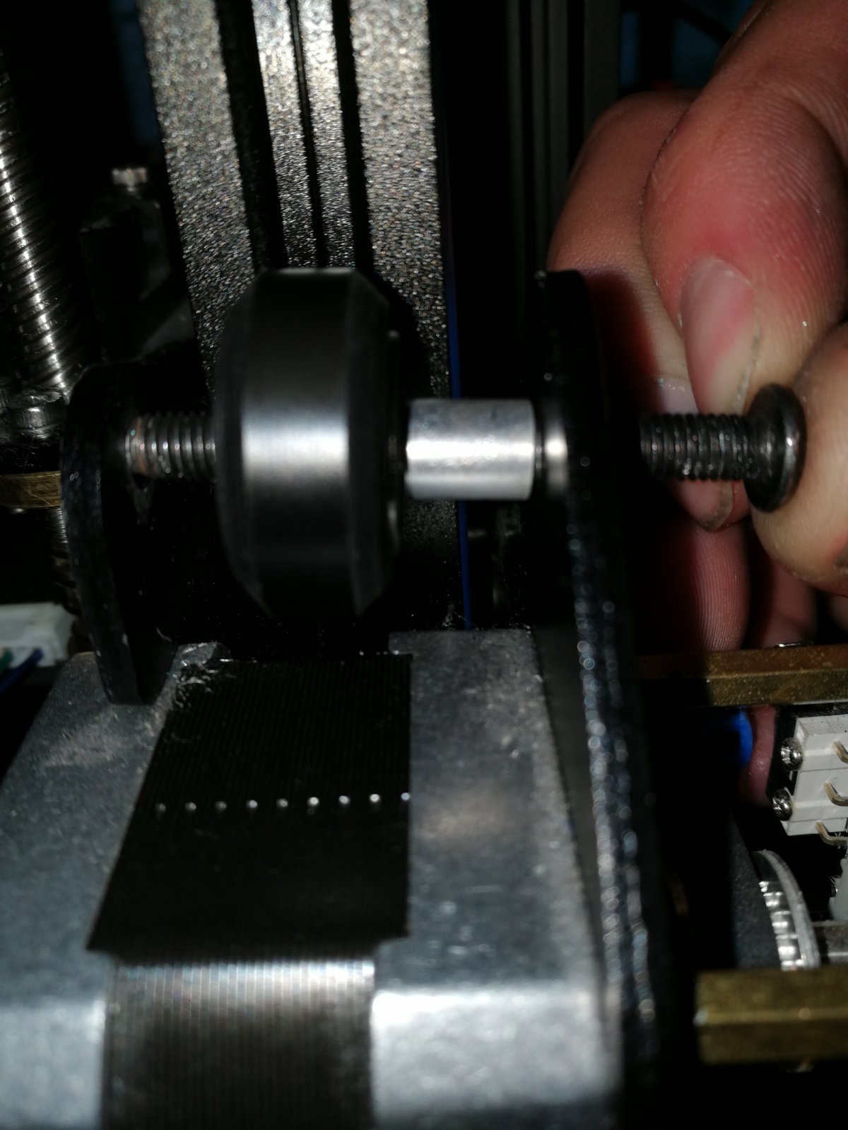

I think I have found the problem, I just disassemble the left wheel up, and the wheel on the bottom left turn by hand. The holes for the screw do not align, can we correct that?

This is a picture
Re: Hard point on z axi
Hi, Are you referring to the screw type mismatch?
You can get in touch with your sales to replace it.

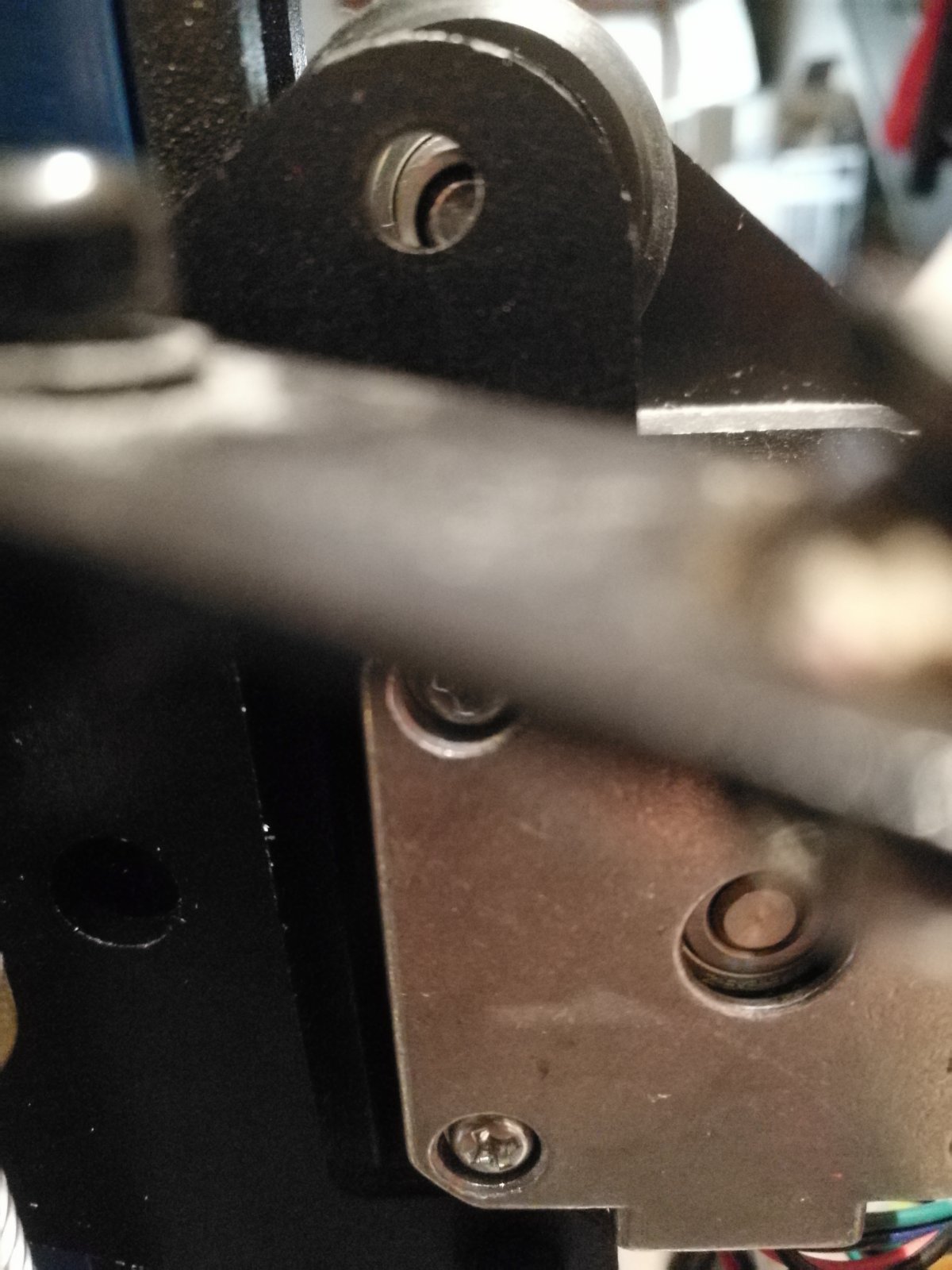

Post by Briciou62500 »
is not in front of the hole
:) You can change the bearing wheel to change this situation.
I changed the wheel and the supports. And I still have the same problem :(
you don't have another solutions ?
Thank's.

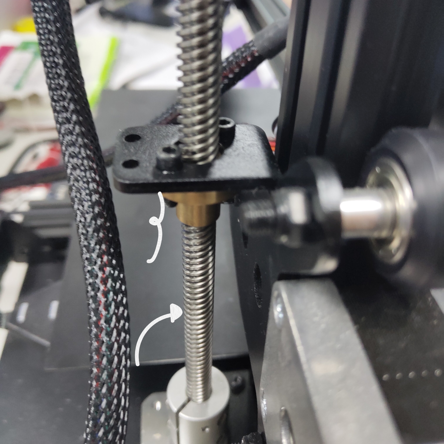

Hi, You can check if your z-axis threaded rod is bent or missing;
Check if your brass nut is too tight and loosen properly;
Check if the bearing or the pulley is issued (issued with lubrication and lubricated).
Thank you for your help :)
Sorry, when I say that I still have the same problem I talked about the screw that does not fall in the face of the hole, for all I changed by new supports.
Regard's
Oh, I refer to the threaded rod of the z-axis and the tightness of the brass nut.
such as:
