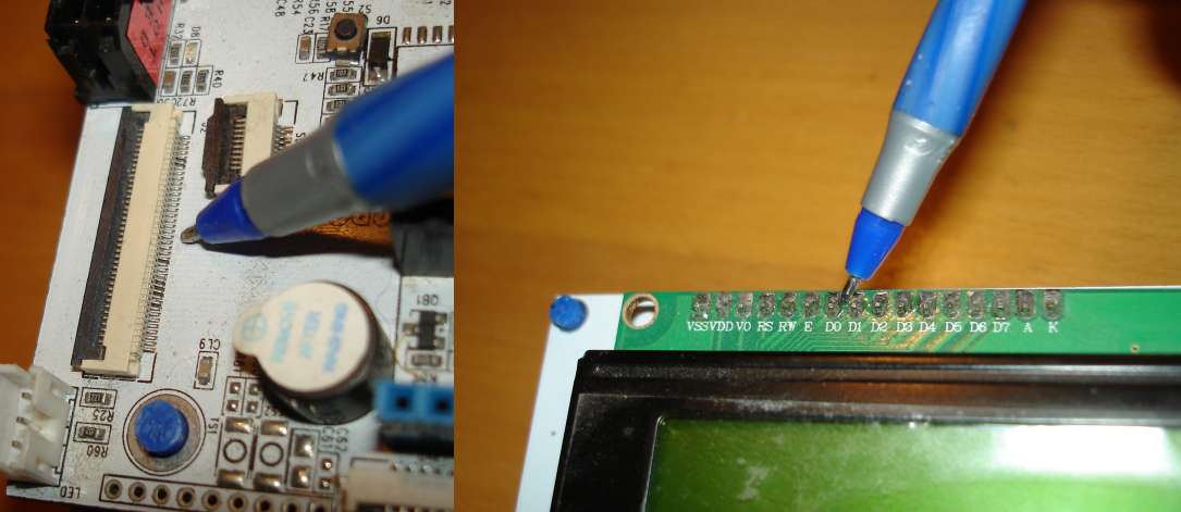

I would like to ask you to test all connections to the display module with your circuit continuity tester.
But in a specific way.
Conect the controller with the display module using the FFC cable. Disconnect all other wires from the controller.
Test the leads I pointed out with a pen in the picture. The circuit diagram will be very helpful.

There is no continuity at those points.

by _kaktus_
Hi.
:mrgreen:
Then you have diagnosed the fault and it is very easy to fix.
I think there are cold soldering somewhere.
All you have to do is to improve the soldering points and everything will work like new. :D
If you have any more problems, feel free to ask.
