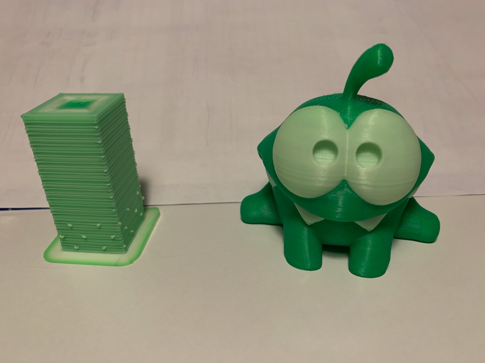

I have included a photo of the OmNom with the prime tower.
The prime tower has a white ring between the two green ring all the way down to the first layer, but the OmNom is green for the first many layers. So I don’t quite get why the tower isn’t all green for the bottom layers.
By the way I think that after I got the bed leveled correctly and a more solod prime tower that gives me a more distinct shift between colors, the A10M is a very solid printer.
