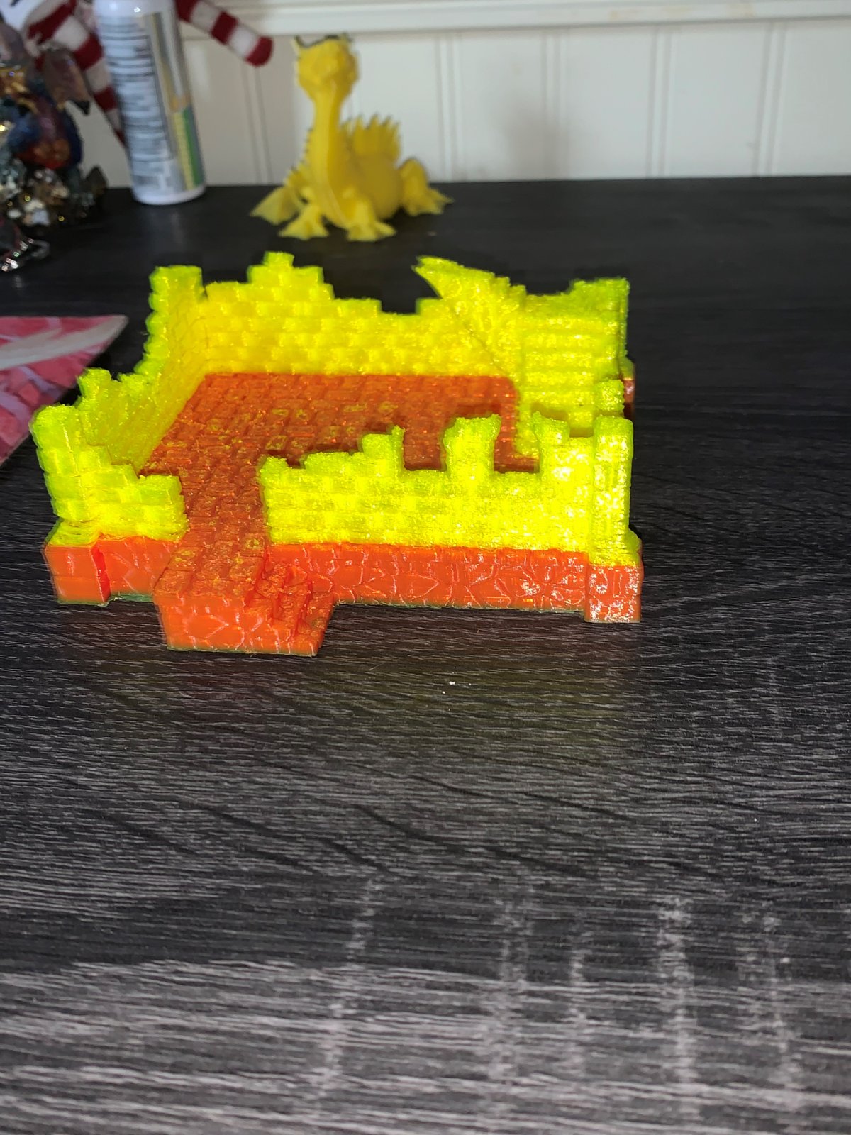

You can get color mixing to work properly with this printer and the a10t but you need the right filament. Any opaque filament will not work, so most PLA is out of the question for proper mixing with these printers. If you get translucent filament in the colors you want it will have the desired effect. I have used https://www.amazon.com/dp/B0746FL41L/re ... UTF8&psc=1 for this. Mechanically, the filament still gives the toothpaste effect but, because it is transparent it lets you see the second color through it and gives the appearance of proper mixing. For this print I used the yellow and red filaments in a 50/50 mix for the orange, and then pure yellow for the top,and for the brim and the first few layers i used 33%blue, 33%yellow, 33% red. There are flecks of yellow at the top of some of the floors due to not measuring the wall height properly, but there is no toothpaste effect visible on print, look at the stairs to see, its a consistent orange
color mix.jpg (349.3 KiB) Viewed 6166 times
With transparent filament you can use the provided geeetech color mixing software to get the color you want, or you can set up virtual extruders with the mix you want in cura and get harder color switches like I did here.
