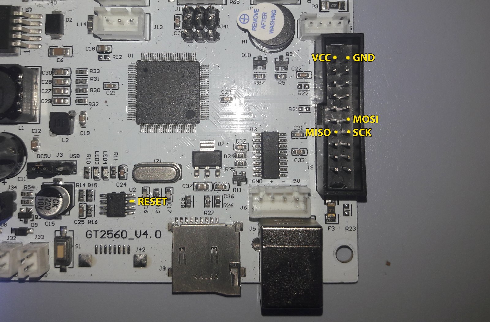

Suggy
Posts: 31
Joined: Tue Oct 11, 2016 1:13 am
Re: GT2560 V4 Connections for Installing Bootloader
Post by Suggy »
Reset pin dident work for me had to wire mine like this
