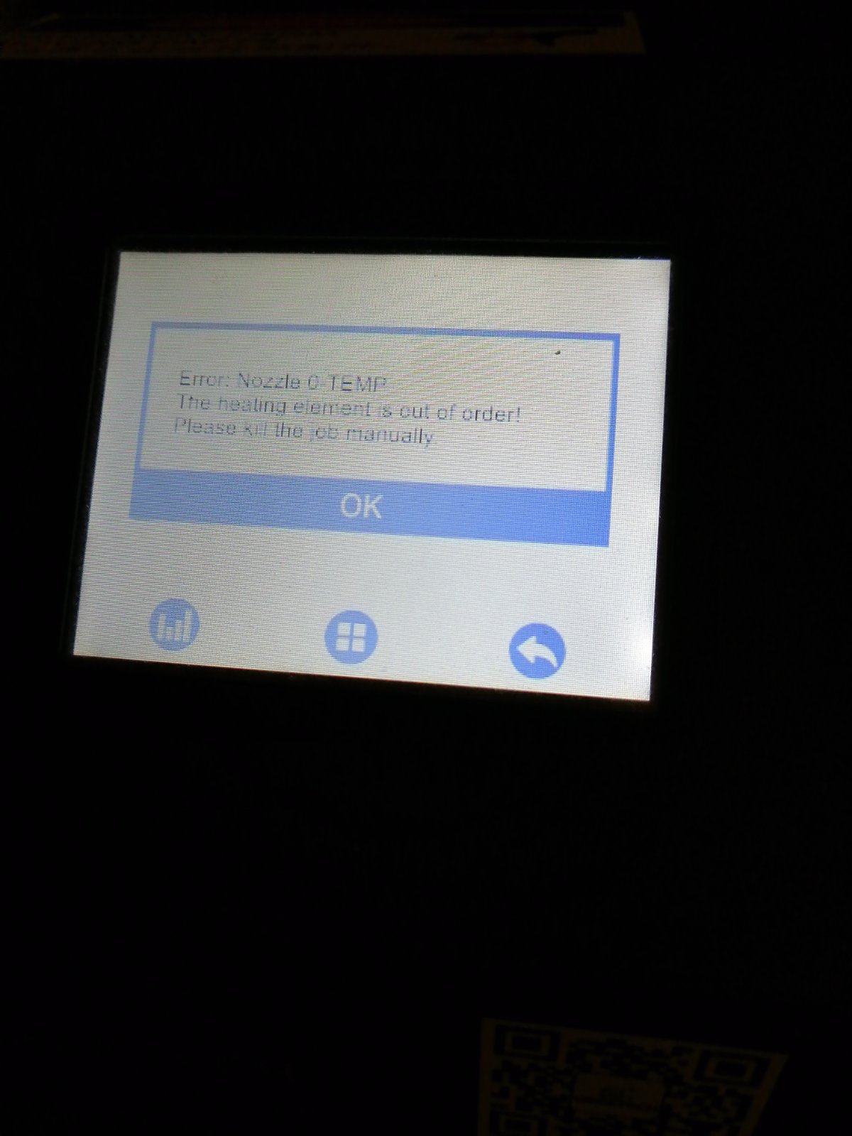

After new test.
I heat just my bed. But my bed don't heat and I have the error : Error : Nozzle 0-TEMP The heating element is out of order! Please kill the job manually.

Re: My printer don't print
Hi, Check whether the thermal bed thermistor is loose.
Then measure thermistors on the hot bed.

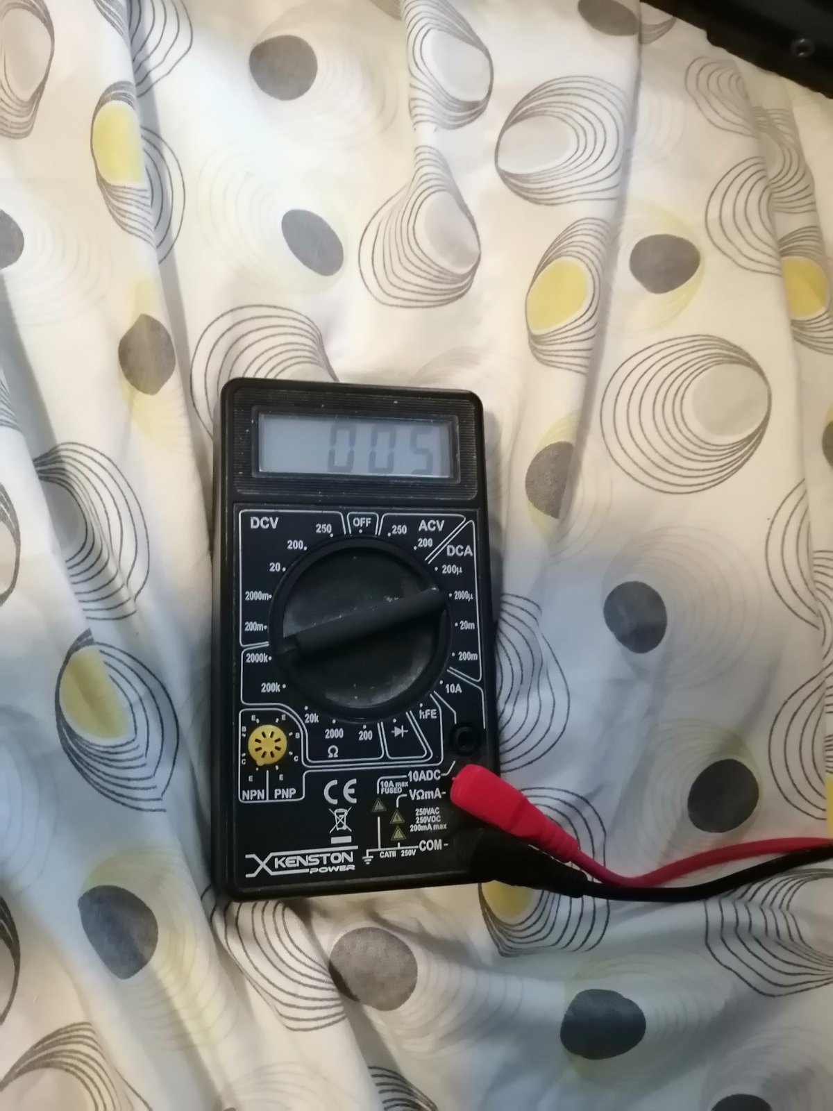

you can use the multimeter to measure the blue-green line of a hot bed.Briciou62500 wrote: Fri Mar 27, 2020 4:55 pm Sorry,
How to check whether the thermal bed thermistor is loose?
And how to measure thermistors on the hot bed?
With printer on or off?
In ohm meter?
In ohm meter?
when the printer is off
and you can check.
I have 005 ohm.
On the multimeter, I am on 2000k ohm
