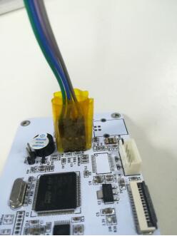

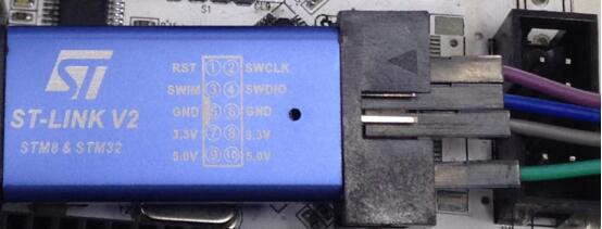

Re: A30 blank screen
Hi,need to connect first: VCC of ST LINK is 5V. And please pay attention to GND and VCC, look at the color of the line (pictured). You can use the st-link brush to guide when the line is connected correctly.
