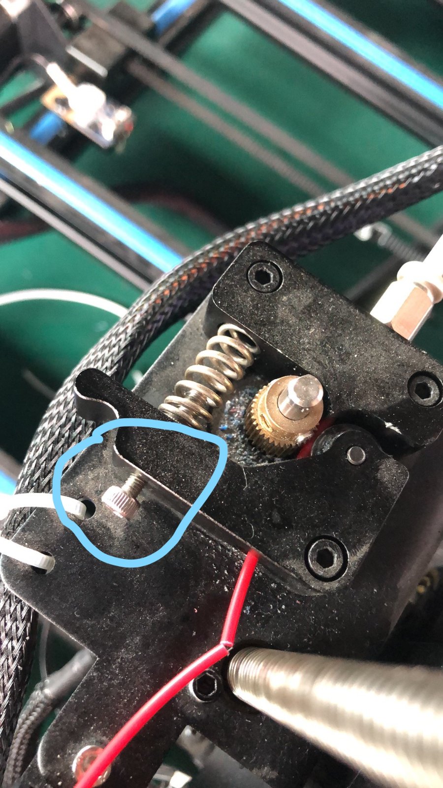

It is recommended that you check whether the feeder is too tight and the consumables cannot enter normally, which can be adjusted by this knob.

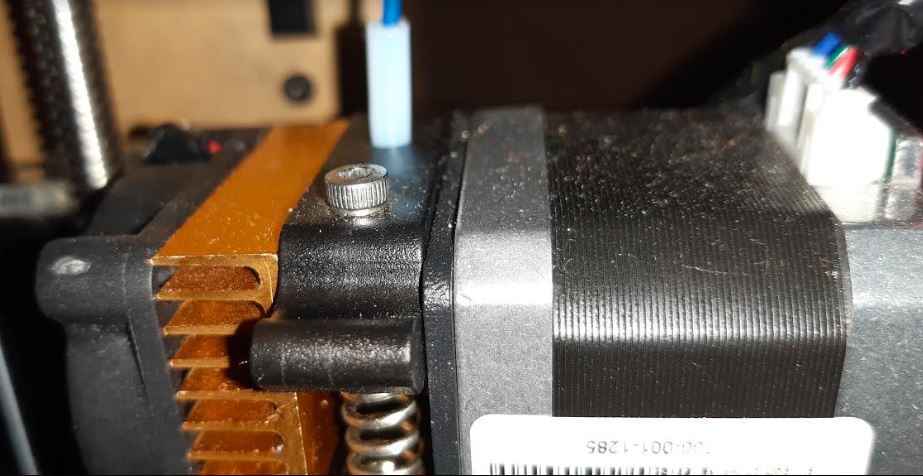

This is a picture of the knob:

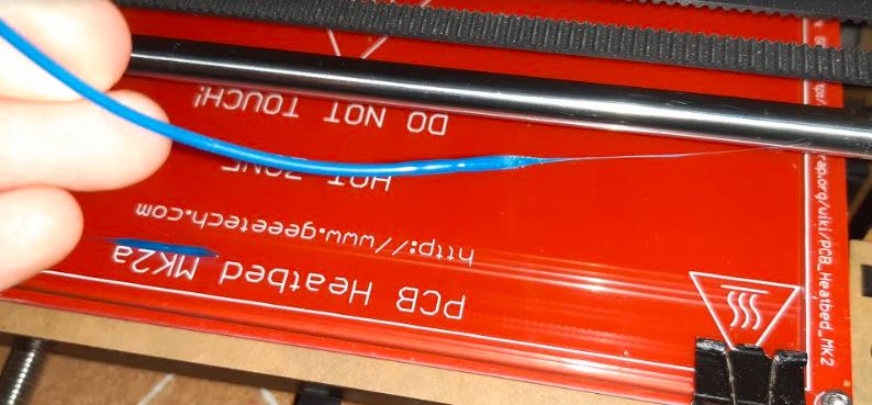

Just to add that the filament never broke inside, in fact, when the filament stops flowing and i have to cancel the print, i open the program repetier/host, to heat the nozzle, then when it reachs a temperature of 210° i just use the manual control in the program to get 10 filament out, then i choose 50 filament in and the filament starts to be consumed without issue and the flow starts again from the nozzle. (also im attaching a picture of how i see the filament if i take it out)
