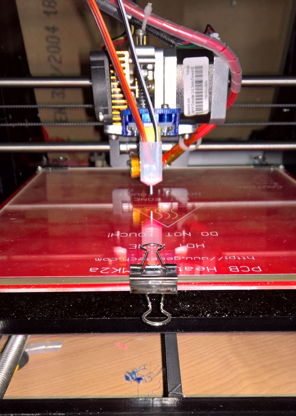

Hello,
Today I try the calibration and maybe I don't understand or it doesn't work !?
First I click on go home button and X axix go to home, that's right,
two: the bed go to home that's right too.
three: the x axi move to the center and the bed go to the center and the 3d touch captor move up and down, "I think for calibration"
I do the calibration with M851 etc....M500...
But Must I do that when all axis are go to home ? for me yes, I mean when the x axis and bed are in the center ??
A picture will be more simple, this is the state of my printer when I click on "go to home for all axis in repetier"
Thanks a lot
