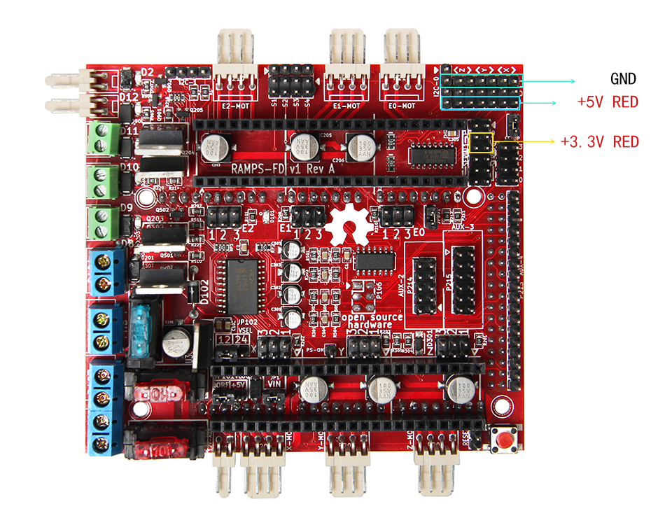

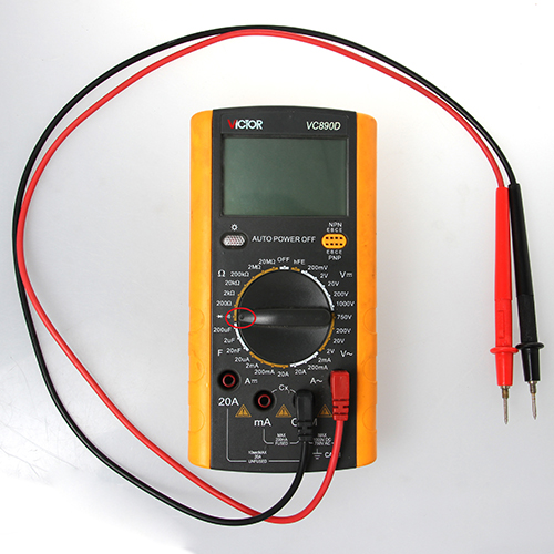

1.first,you should set the multimeter like img 4021
2.then test these point +5v(RED Probe)& gnd(black Probe) and +3.3v(red Probe) & gnd(black Probe)。
if If the multimeter tweet,the FD is short with power

I get 7V where it should be 5V, and nothing at all on the 3.3V
Alex-w
Posts: 148
Joined: Thu Jun 05, 2014 2:24 pm
Re: RAMPS-FD
Post by Alex-w »
i meens that test the power and gnd。are they short?NOT test the voltage
