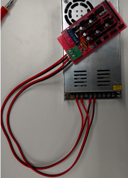

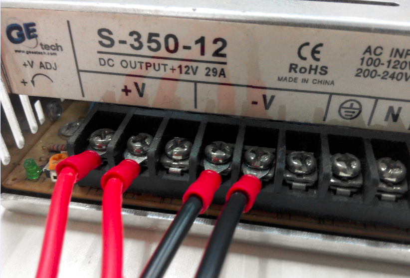

Post by zhangxueyou »

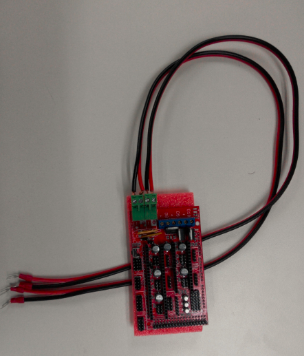

Wiring of power supply cable
Wiring of power supply cable.png (281.58 KiB) Viewed 34073 times
Wiring of power supply cable2.png (373.01 KiB) Viewed 34073 times
Wiring of power supply cable3.png (691.46 KiB) Viewed 34073 times

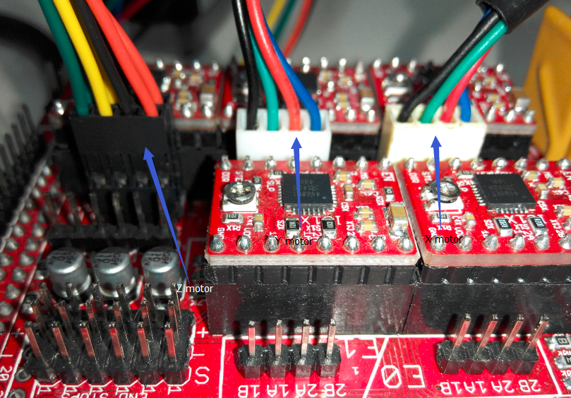

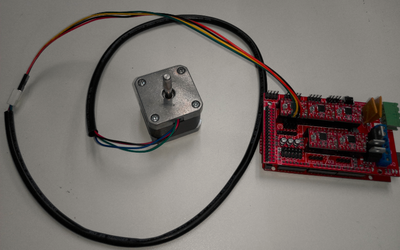

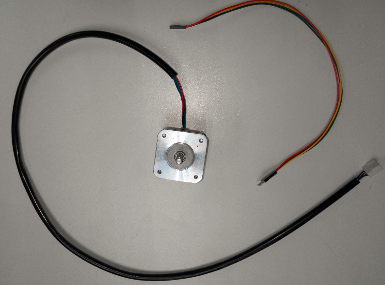

zhangxueyou
Posts: 1405
Re: Require full Prusa I3 Aluminium Kit Assembly Instruction

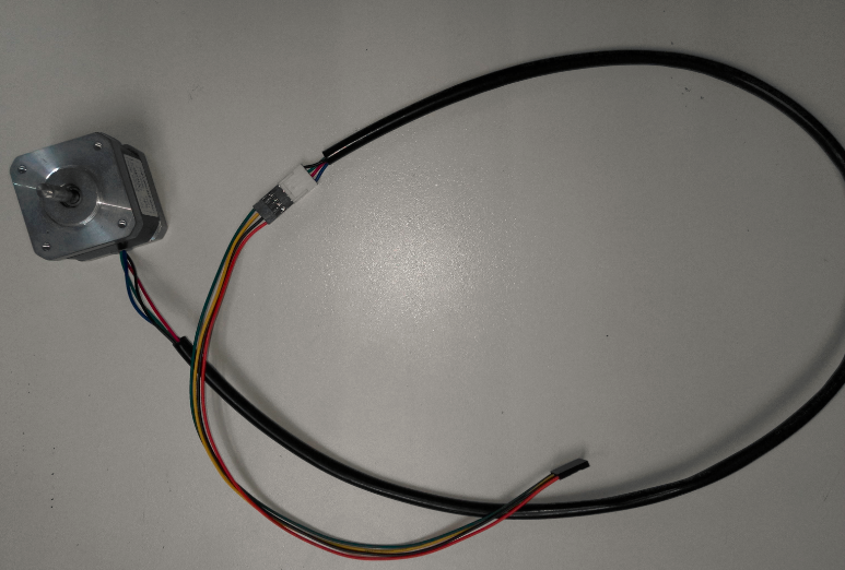

Z motor (2 in all)
Z motor(2 in all).png (535.02 KiB) Viewed 34073 times
Z motor(2 in all)2.png (435.72 KiB) Viewed 34073 times
Wiring of Z motor.png (515.74 KiB) Viewed 34073 times

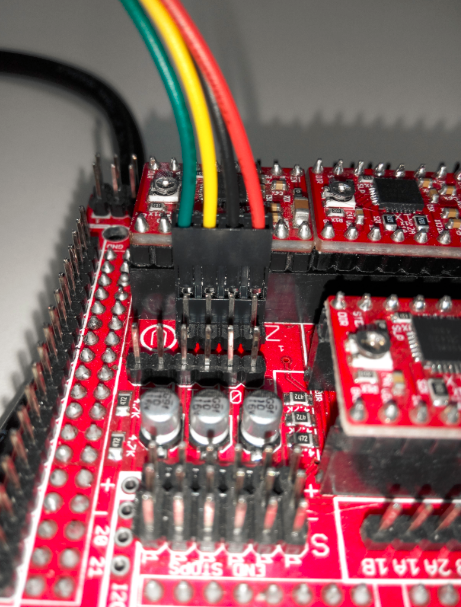

Wiring of Z motor
Wiring of Z motor3.png (422.18 KiB) Viewed 34072 times
Wiring of Z motor2.png (426.99 KiB) Viewed 34072 times
Wiring of Z motor4.png (792.78 KiB) Viewed 34072 times
The pictures above are all the wiring of each part. Hope it will help you successfully complete it.

I did notice some small errors in your wiring perhaps.
1. The Z axis can not be wired like that unless you supply in your kit 2 extra wires. The plugs on Z axis board would not fit without thinner plug adaptor.

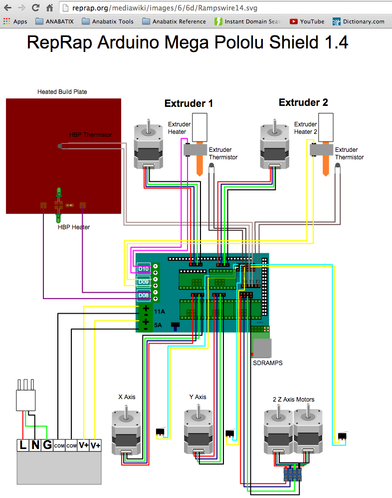

2. End stop wiring is different to RepRap project pin positions. So I will try Reprap wiring diagram first. And it depends on if they are for minimum or maximum end stop position.What are your thoughts?
Reference http://reprap.org/wiki/Prusa_i3_Rework_ ... ors_wiring
Kind regards
Lee
From Reprap site: http://reprap.org/wiki/Prusa_i3_Rework_Electronics_and_wiring#Thermistors_wiringhttp://reprap.org/wiki/Prusa_i3_Rework_Electronics_and_wiring#Thermistors_wiring
Screen Shot 2015-02-17 at 12.33.31 pm.png (124.17 KiB) Viewed 34053 times

1. There is no enough zone to plug Z motor directly. So we add Dupont wire, can you see that in the picture?
2. I am so sorry for this, because I am new guy. I need time to know these things step by step. So please forgive my fault. And thank you for your tips.
Good luck!

Yes the photos were a good help. The Dupont wire was not in the kit so I had to order some from a local supplier.
