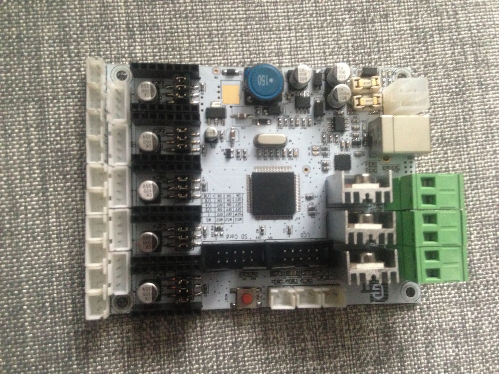

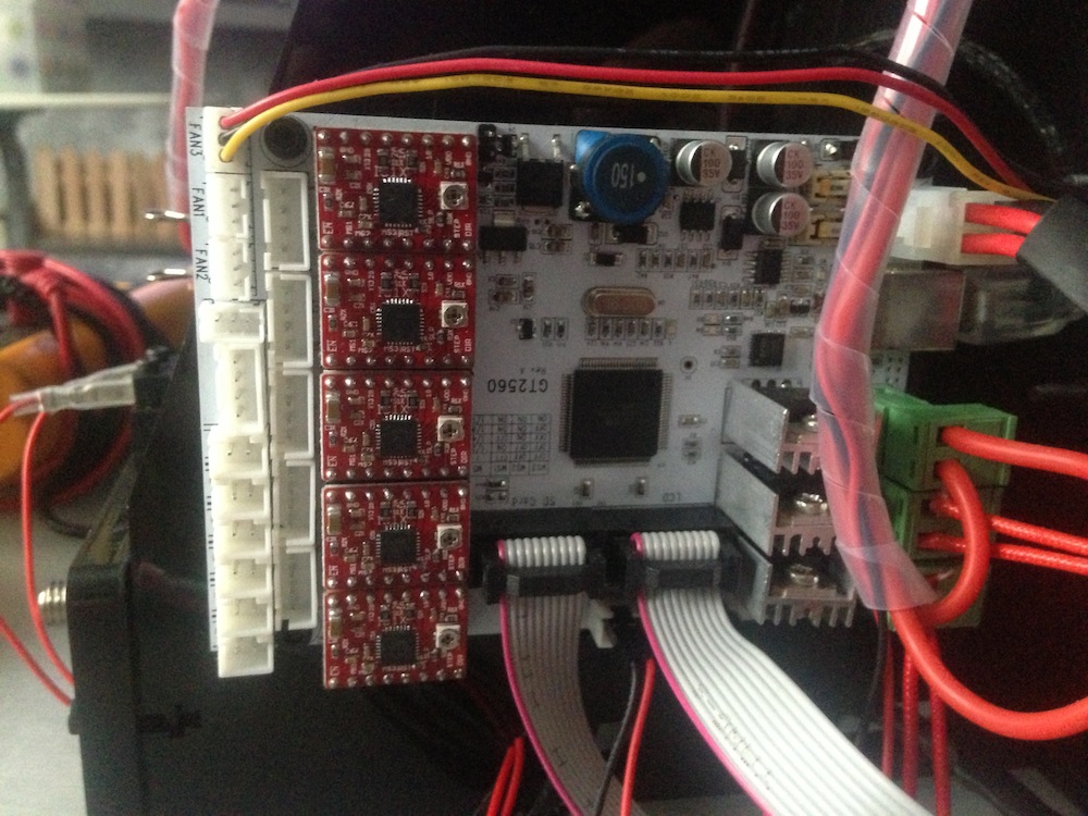

This is my old board
And this is my new board
I was upload the firmware that you send me.
Externally board is different location of the ports of endstop of axes. On the old board they installed parallel to ports of motors, on the new board they installed perpendicular to ports of motors.
