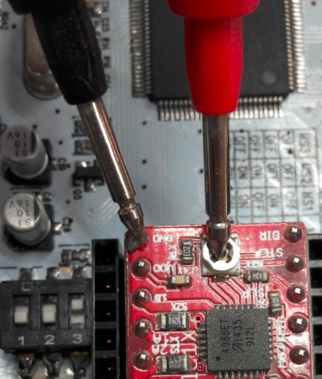

As for the screw and testing voltage, could you please clarify or provide pictures? Where is the screw on the motor? How do I test the voltage? I do have a multimeter.

The following picture shows how to test the voltage between screw and GND:
test referring voltage.png (438.77 KiB) Viewed 13841 times

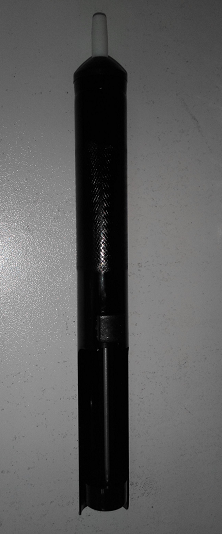

There is a tool that can remove the melted tin:
MEJiangster
Posts: 36
Joined: Tue Jun 23, 2015 10:00 am
Re: LCD high Pitched Sount
Post by MEJiangster »
I already have this tool. This isn't what's wrong. I've removed all the spldering but there's still something holding the beeper in place
