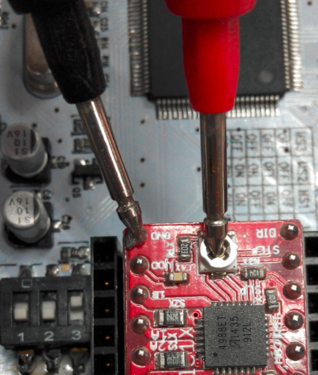

Great advice, I will put lubricant on both the smooth and threaded rods and see if that helps.
As for the screw and testing voltage, could you please clarify or provide pictures? Where is the screw on the motor? How do I test the voltage? I do have a multimeter.
How do I remove the beeper from the LCD? What was it there for in the first place?

The following picture shows how to test the voltage between screw and GND:
test referring voltage.png (438.77 KiB) Viewed 13851 times
Some printers are set to beep after finishing printing in firmware, so the LCD has a beeper.
You can use a electric soldering iron to remove the beeper.

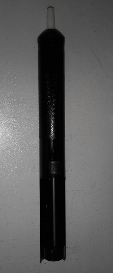

There is a tool that can remove the melted tin:
Re: LCD high Pitched Sount
Posted: Wed Jul 01, 2015 9:48 pm
by MEJiangster
I already have this tool. This isn't what's wrong. I've removed all the spldering but there's still something holding the beeper in place
