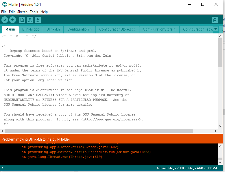

I have installed Arduino 1.0.1 to my Windows 10 PC but I can not get the Marlin sketch to compile. "Problem loading BlinkM to the build folder." or "Problem loading ??? to the build folder". How do I eliminate these compilation errors? There is not much help here. I don't want to play with Arduino. I dont know how. I want to use the printer that I paid for.

Maybe you can attach a snapshoot of the error message,so we can learn more about it.

Error message from Arduino:
- Ard_error1.PNG (27.73 KiB) Viewed 32683 times
Re: Solutions for GT2560 extruder not working
You can try the installer version of 1.05,see if it works.

In order to access E1 because E0 quit working I spent 4 days doing a work-around.
My efforts to upload firmware to my Geeetech Prusa i3 a pro:
I gave up on Windows 10 machine with Arduino 1.0.1
I returned to my laptop-- Ubuntu 16.04 --Arduino 1.68 or whatever is newest. I found someone's direction about a u8glui (spelling?) library. I linked that library, ran the Marlin software, swapped the pin assignments for all three values for E1 and E0 and voila. it works.
