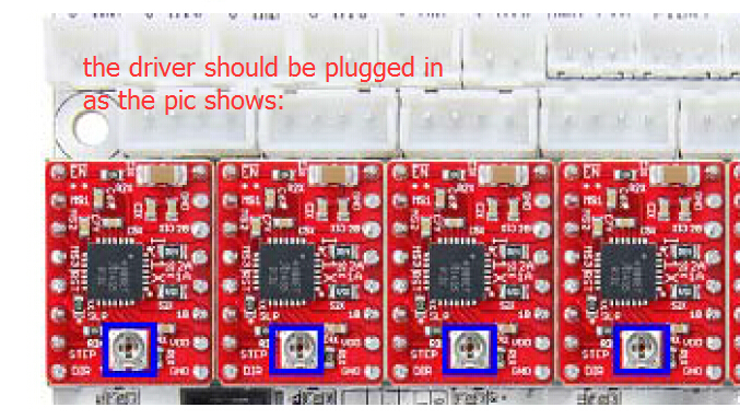

"When trying to drive the Extruder through Repetier there is no motion, When trying to get the extruder motor to drive using the .1 feed on the LCD control panel I get NO motion."
So both of your extruder motors can't turn either using repetier or LCD? then you can swap the motor with X or Y axis motor to check if it works. And check the driver direction , if you plugged it in
the wrong direction, it might be damaged.
- QQ截图20150828172225.jpg (410.61 KiB) Viewed 13786 times
