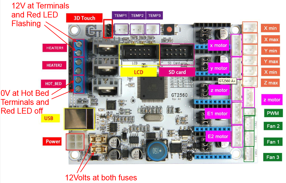

I used Arduino 1.0.1 and was able to load the Firmware onto the GT2560 board. When I turn on the printer and activate the extruder and hot bed, the extruder heats up, but the hot bed does not. I checked the fuses and they both have 12V on both ends. When I check the Heater 1 terminals, they have 12V. When I check the Hot Bed terminals, they have 0V.
Since power is being applied to the Hot Bed fuse, shouldn't there be power at the Hot Bed Terminals?
Is the board defective?

Re: hotbed/extruder is not heated up(GT2560/GTM32/sanguinolo
The voltage of hot bed terminals will output only when you give a heating up command to the board.Here is a troubleshooting post about why hotbed is not heated up,and you can refer to it:http://www.geeetech.com/forum/viewtopic ... 19&t=17039.ggrshelton wrote:I used Arduino 1.0.1 and was able to load the Firmware onto the GT2560 board. When I turn on the printer and activate the extruder and hot bed, the extruder heats up, but the hot bed does not. I checked the fuses and they both have 12V on both ends. When I check the Heater 1 terminals, they have 12V. When I check the Hot Bed terminals, they have 0V.

I checked the power on LED's for the hotbed and extruder and discovered that the hotbed LED was not illuminated when power was applied to the board. I then inspected the surface mounted fuse holder for the hot bed fuse. It was loose on one end from the board, which is why power was not being transferred to the hotbed. After experiencing a burnt 15A fuse failure on the original board followed by a replacement board with unsoldered hotbed surface mounted fuse holder, I can only assume that Geeetech has an issue with the GT2560 board. If you check the number of reviews of this post it is almost 10,000.
I was able to grind down a soldering tip for my solder iron and re-attach one side of the hotbed fuse holder to the PCB and am back up and running. I have no idea if when I increase to an ABS hotbed temperature of 100C the solder joint will hold? It appears that the weak point of Geeetech's PCB is the ability to supply sufficient current to the hotbed.

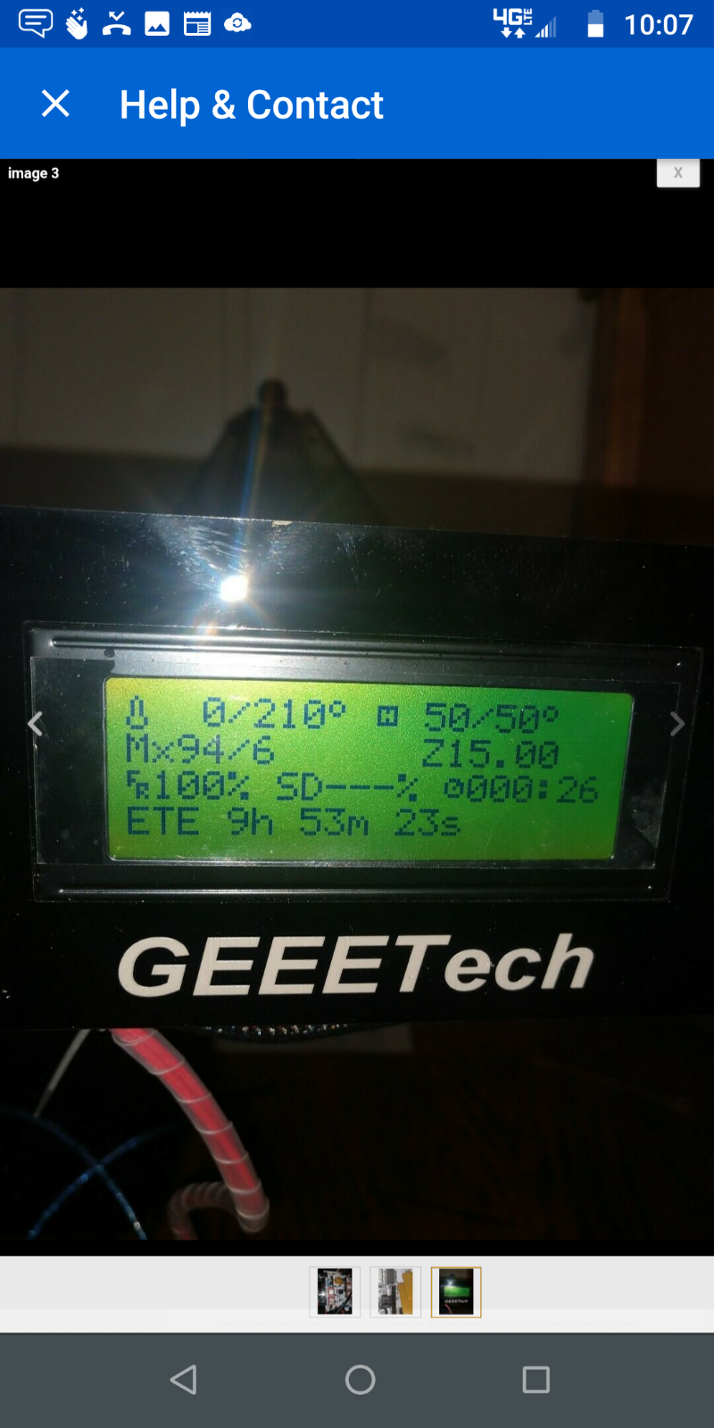

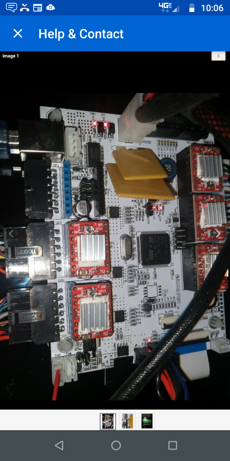

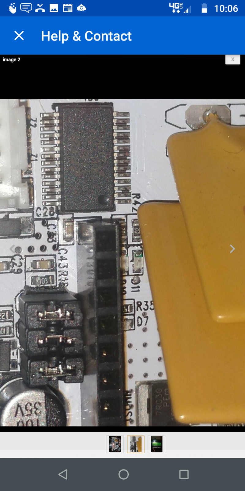

Re: hotbed/extruder is not heated up(GT2560/GTM32/sanguinololu)
all the pictures are of a different board , the hotbed heats up and the hotend shows 0/0 this is what my board looks like when it's trying to print but the hotend is not heating up. U can see the lights that are red in the first photo and in the second photo the light marked D11 is blinking yellow I have no clue any help would be great

My printer model is Geeetech Prusa I3 M201 2 in 1 out your info does help a lot still not sure got to sit down and spend some time on it to figure it out don't have a lot of time I seem to be working to often but any info u may have helps a lot thank u
