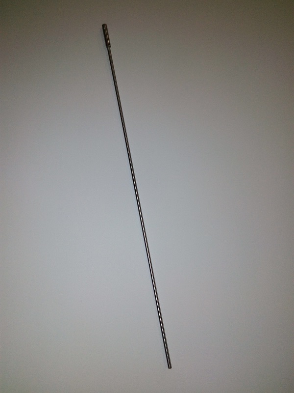

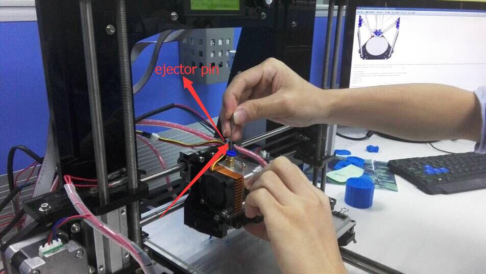

Hi,Alex
Look the following pic,this guy use a tool we called Ejector Pin to clear the clogging,i guess it was included in your package when you received it before,and you can use it to clean the jam.
alexvolk
Posts: 3
Joined: Wed Aug 24, 2016 3:47 pm
Re: Extruder not working
Post by alexvolk »
Thank you very much William Kwok! cleared my clog and the printer is working perfectly! Very much appreciate the help!
