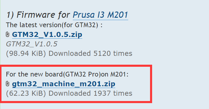

Dear friends, I have a m201 with gtm32 Pro B card, I do not know what to do, I can not find the firmware updated for it, I am in version 1.0.3 going through several problems, please somebody help me.
Thank you all

eltonaappl@gmail.com wrote:Dear friends, I have a m201 with gtm32 Pro B card, I do not know what to do, I can not find the firmware updated for it, I am in version 1.0.3 going through several problems, please somebody help me.
Thank you all
Hi,you can download different version of M201 firmware in this post:http://www.geeetech.com/forum/viewtopic ... 20&t=17046.
Thank you all
Hi William, thank you very much for the quick response, can you tell me which of these firmware I should download?
Well in the link that you sent me, has firmware of all models, in advance, thank you.
Thank you all
For GTM32 Pro,you can download this version.
