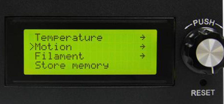

BTW I have to do the reset procedure every startup, is there a way to store it permanent?
tnx
Re: Me Creator 2
Hi,8ung
you can find it in LCD main menu:Control>Store memory.Just the attachment shows.

William wrote:Hi,8ung
tnx William it worked
