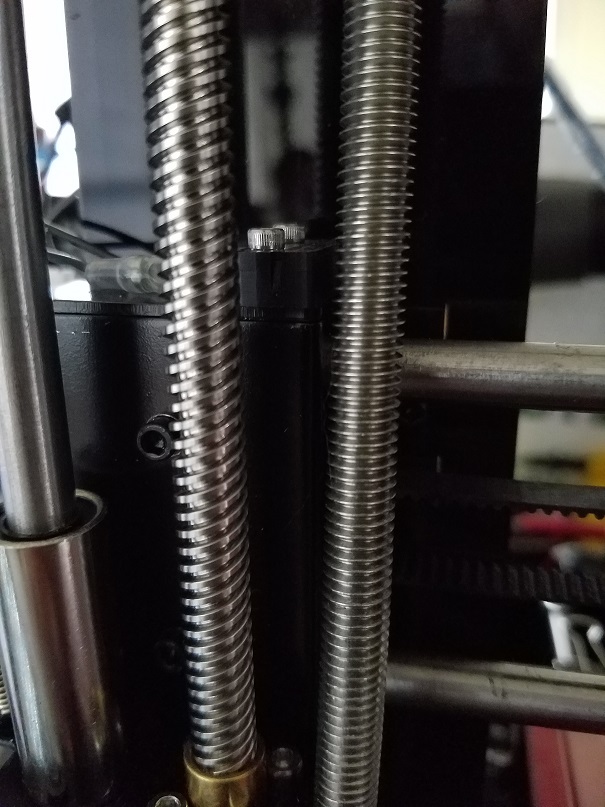

The rods that came in the kit were both slightly bent. Rather than try to straighten those out I bought new ones that are a different pitch.
I accounted for the change of rods in the steps/mm setting, although since I can't upload firmware successfully I can't change any other parameters.
The screw you shipped is on the right. The screw I replaced it with is the larger pitch Lead Screw Diameter: 8mm
Screw Pitch: 2mm
Lead: 8mm
Lead Screw Length: 300mm
I've mentioned this previously.

Re: Problem with a Prusa i3 Pro C controller and Z axis
I just put the screws provided in the kit back on, the problem is still there.

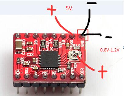

Ok, so I've been talking to the seller, they sent me a new GT2560.
Good news, that fixed the problem with the Z axis
Bad news, now neither extruder moves.
The seller sent me back to you to figure out why that's happening
When I check the voltage across the stepper drivers they're showing 12v. What should the voltage be?

Hi,aja175 wrote:Ok, so I've been talking to the seller, they sent me a new GT2560.
You mean the voltage of which two pins?
