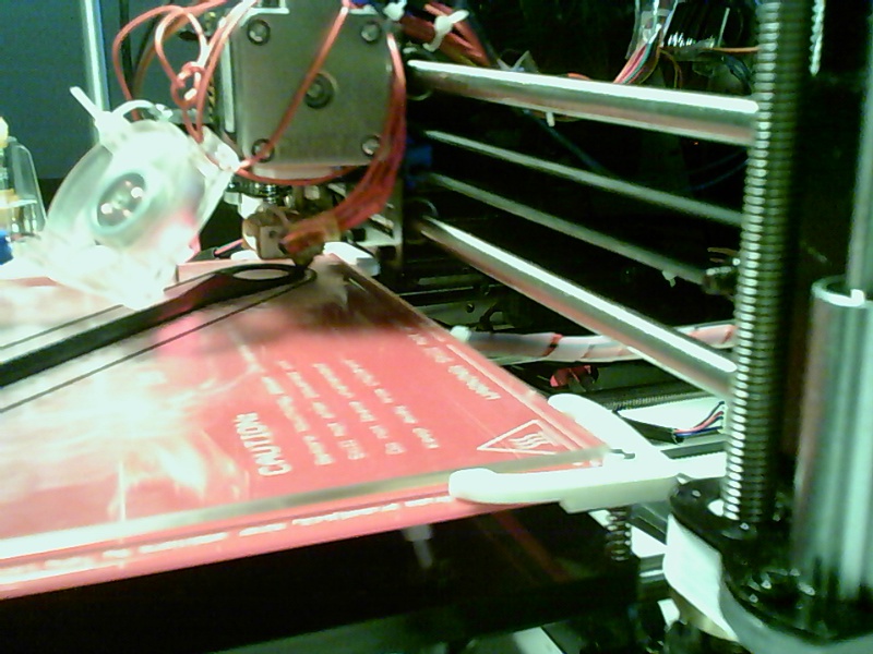

Yes. Geeetech's mount. I will also move my probe. I want it closer to the nozzle. The rear option looks good. My fan is temporarily mounted:
PI3_Pro_B (2).jpg (165.74 KiB) Viewed 17623 times
:lol:
Waiting for new fans/blowers from eBay...
