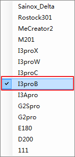

Hi,You can try to using Pro B to upgrade.
