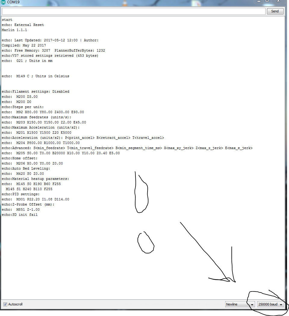

nutts wrote:I have been using firmware downloaded from Geeetech for Geeetech i3 pro B
That is what printer is
So you already sucessfully uploaded the original firmware?
Do you know if your reflash worked?
appswert
Posts: 55
Joined: Thu Jun 01, 2017 5:25 pm
Re: printer not working after changing circuit board
Post by appswert »

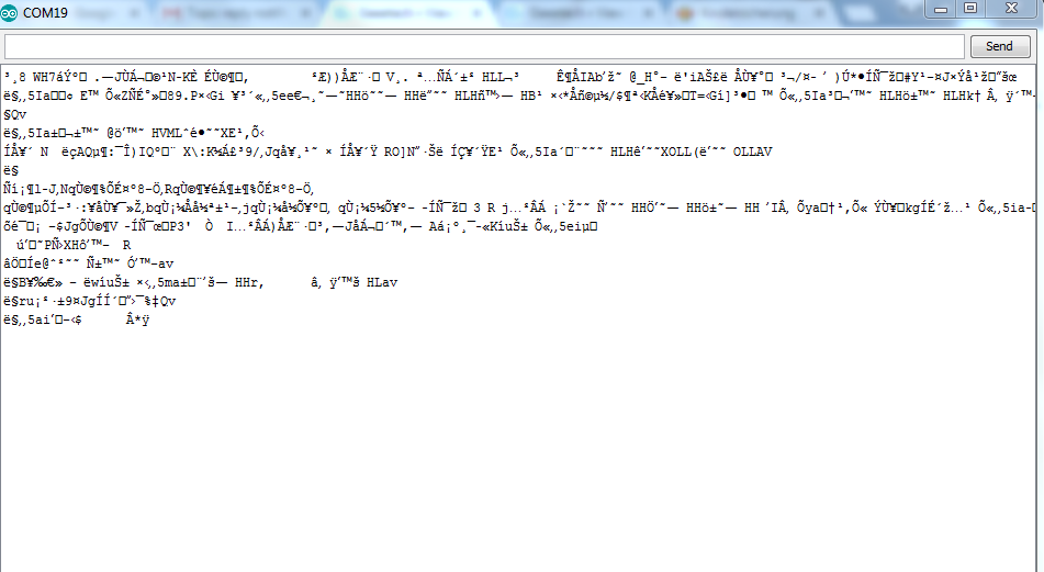

nutts wrote:Could the problem be the Baud rate is to low ?
If so how do I raise it to 250000 ?
When you open the Serial Monitor on the bottom right you can acces a dropdown menu which let you select the baud rate.
But if your baudrate should be wrong there are normaly strange characters displayed.
Normaly if you see nothing than there is something wrong with devices drivers or the com port you selected was wrong.
strange char.PNG (67.92 KiB) Viewed 11019 times

nutts
Posts: 48
Joined: Sat Jun 03, 2017 9:27 pm
Post by nutts »
I did not see anything like you have on your screen
