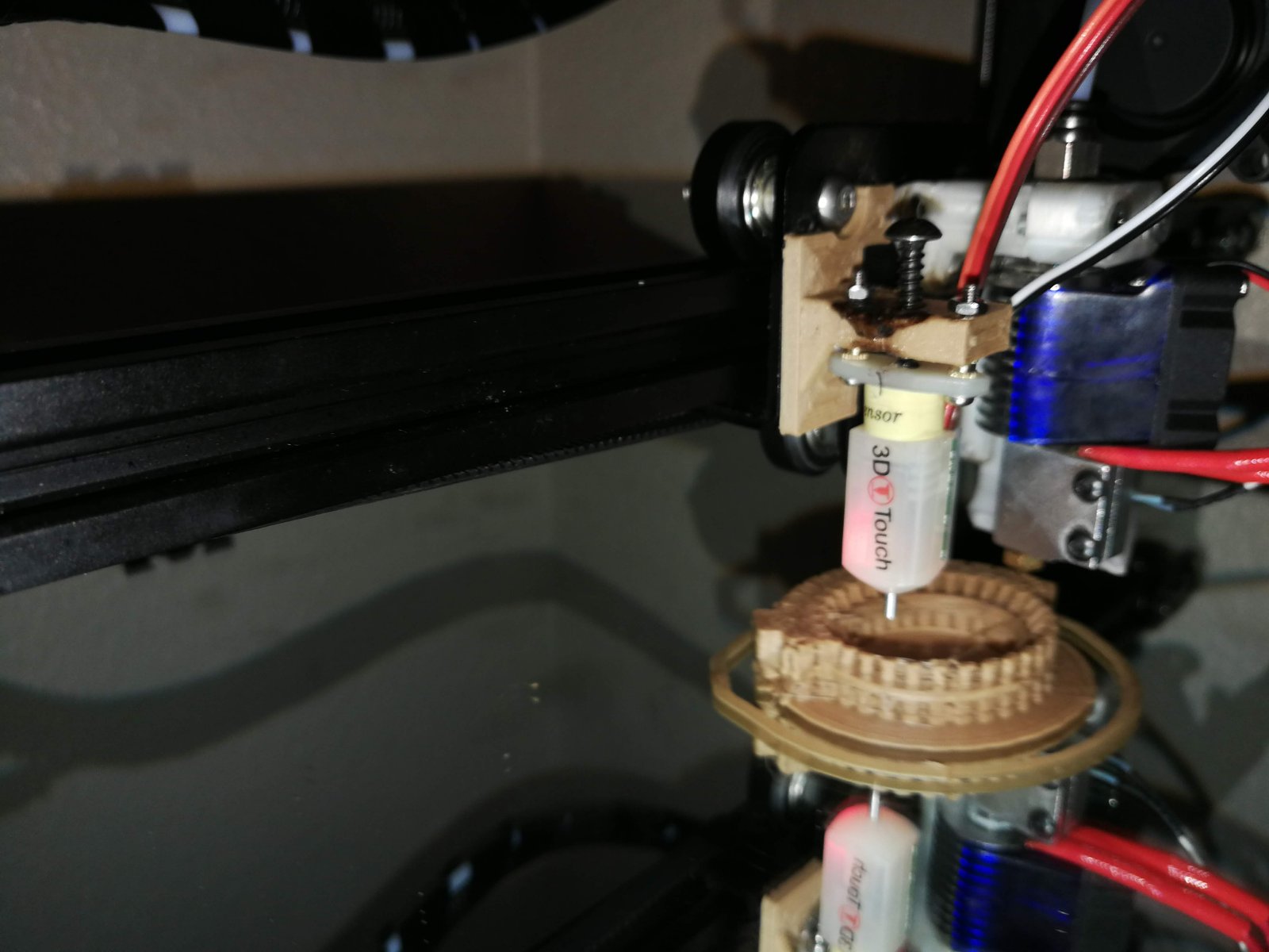

Or at least mine!
Had the same issue pin dropping.
I did the following and it did not work:
Added power through the usb port with a usb cable and phone charger...nothing
Adjusted the screw as recommended (loosen until the light turns off and tighten slightly again) and nothing
But then, it got fixed. I noticed it only worked while I printed with the Allen key stuck in the screw.
I went ahead and added a screw (one that would magnetize) instead of the allen key, and it has not failed!
I think the issue is with the pin not having a complete magnetic profile and thus not able to magnetize and hold the position.
The screw may complete the magnetic profile and it helps hold the pin in place.
I added a picture (hopefully it will show up)
Never mind the blackened part of the holder. That was me heating up with a torch for too long too close.

Thanks for sharing!jerincon wrote: Wed Oct 03, 2018 10:02 am Or at least mine!
